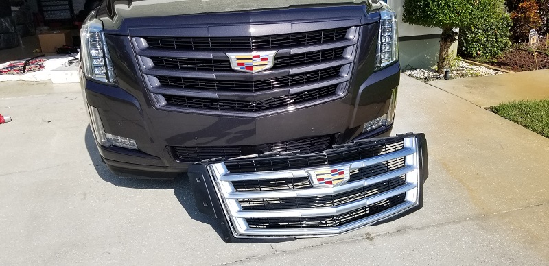

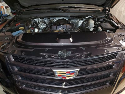

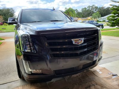

No worries. It's happened to me as well. Thanks for the response and comment. Glad you were able to do a temp fix on that lower grill. I do not blame you. Taking the whole front bumper off in order to get to the grills is not something that I want to do again. Especially because some of those clips are known to break which makes things all the more challenging.
My buddy and I did touch up all of the chips ~ 2 weeks ago. We sanded all of the chip locations prepped, sanded, prepped, then painted the sections followed by the clear coat. It came out great.
1st pic is before. Notice the chips. Next 2 pics are the after. The radiator shroud was done prior. We just barely got around to switching them out.
Have fun with your ride and the mods.
