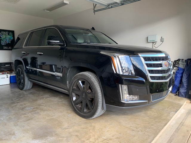

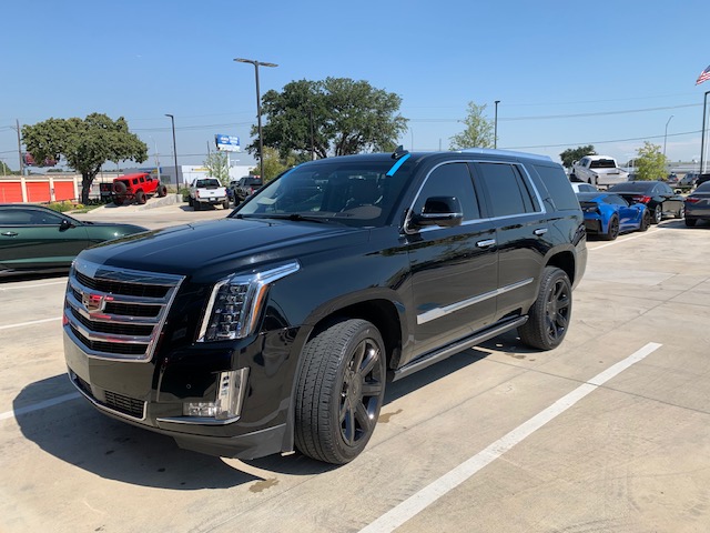

Everybody likes pictures! This was the day I picked her up. Disregard the blue painters tape, dealer had installed a new windshield for me. You can kinda see in the second pic, lower grill on the passenger side is popped in with a broken tab. Ordered a replacement but not sure exactly how to get the original part out, any thoughts?
