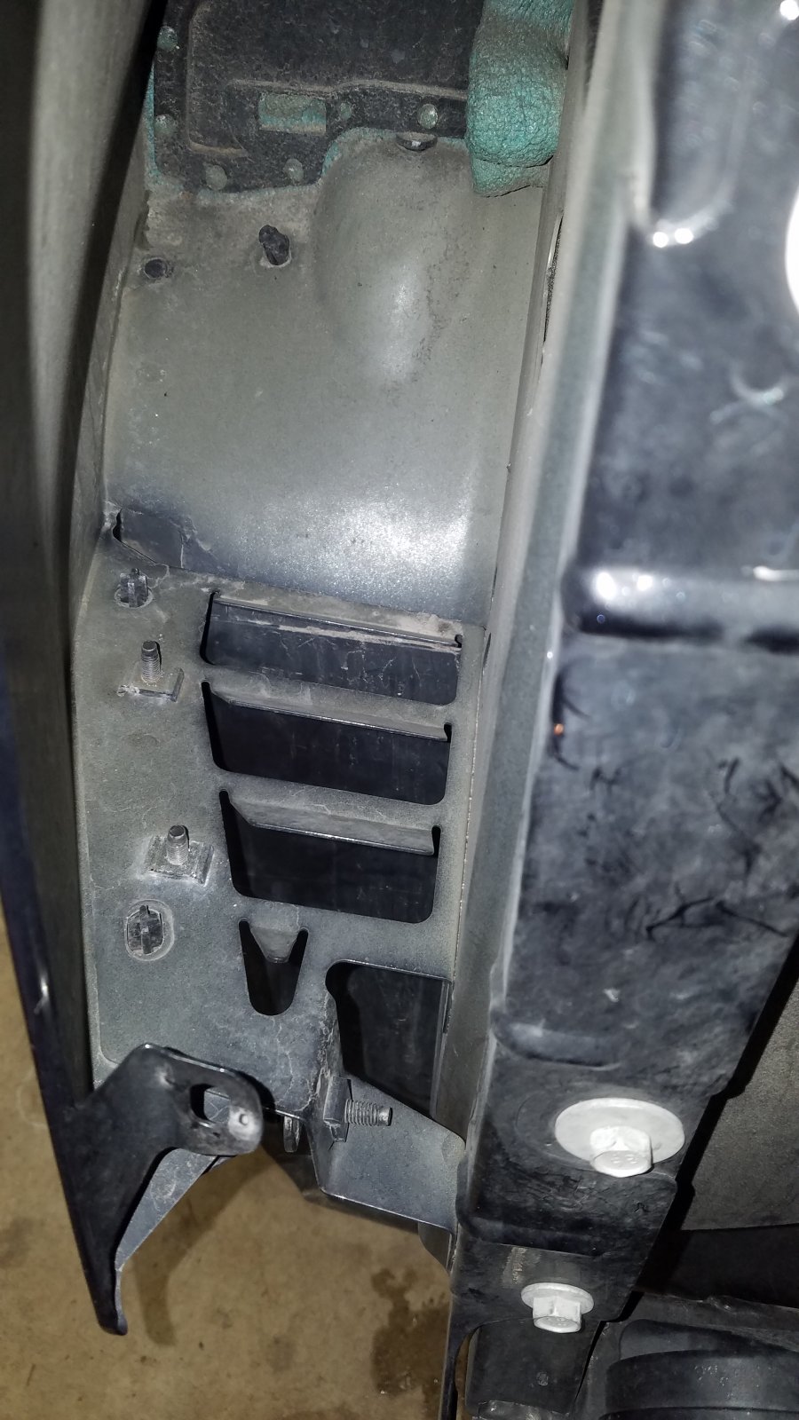

Do you have to cut out the louvers to install that to the airbox? 20200314_211025.jpg
