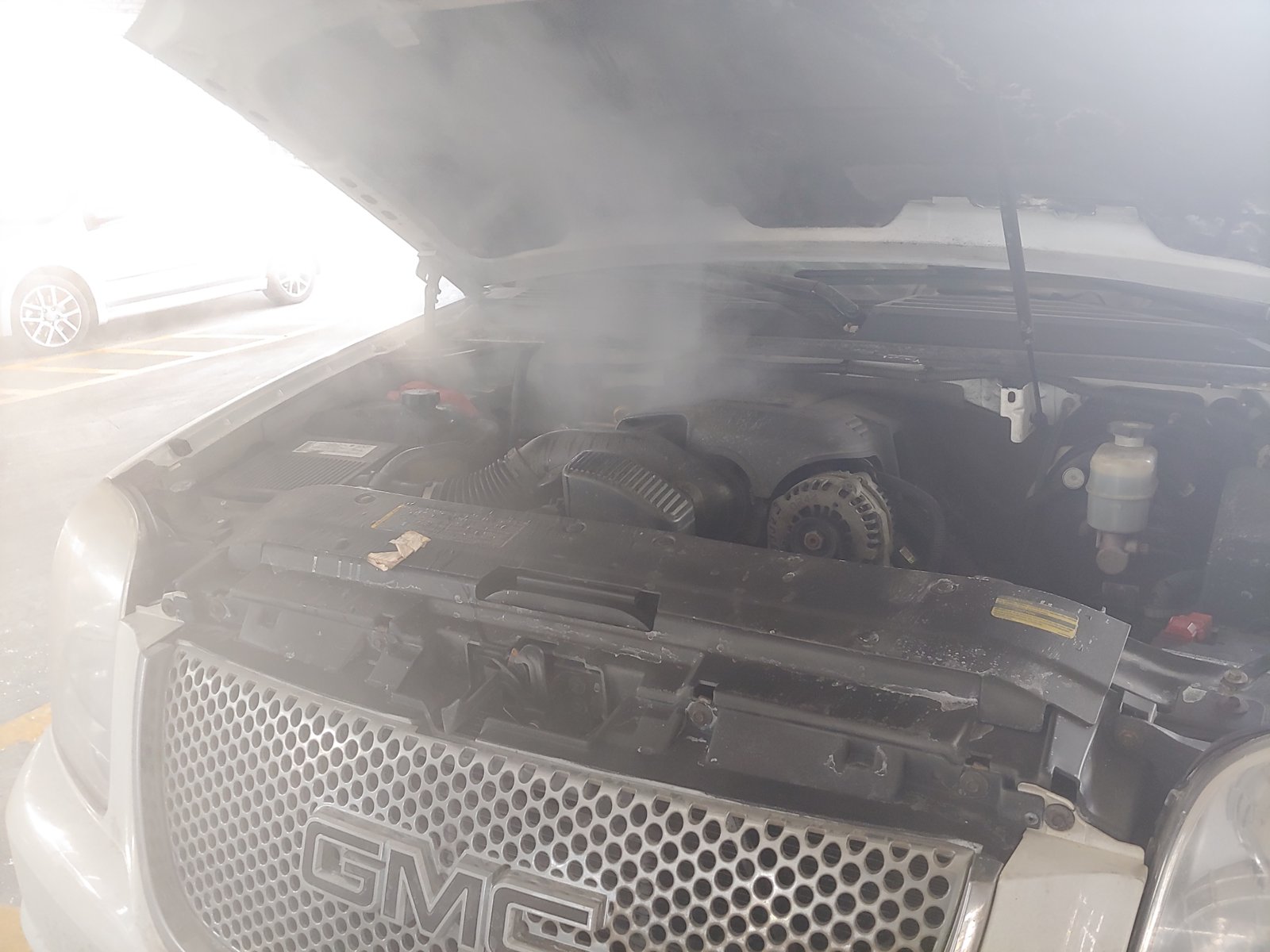

Hi all, just pulled off the interstate and smoke pouring out of engine bay. Looks like this hose came loose and antifreeze got all over the engine...I obviously can't touch it at the moment because it's all smoking and hot but does anyone know should I do a push this back on do I need a new hose is it a crimp fitting is there more to changing this out? It's the hose on the left toward back passenger side of engine.

Heater hose. Looks like the plastic fitting broke. Do not drive it as is. Your coolant has boiled off and it won't hold pressure
As a roadside fix to get you where you need to go, just clamp it off tightly with vise grips or some kind of clamp, refill cooling system, and drive to a repair shop.
Or, if you have AAA or some kind of emergency road service, have it flatbedded to a shop.

That’s called a quick disconnect and it’s kind of a pia to replace. Very common problem. I suggest using a genuine AC Delco not Dorman because the latter are known to fail quickly. But if all you can get is a Dorman then that’s ok too. If you’re doing it yourself, use a pair of snips to cut away the old plastic part, the quick connect is hard to release. There’s 2 different ones, one black and one white. You might just want a shop to do it.

Wanted to just say thank you again for those of you that replied quickly the other day. I had to quickly try and search auto parts stores close to me for who had parts in stock and having you post the part helped get it done quickly.
The Autozone that was about 2.5 miles away had a new quick connect heater hose fitting in stock (Dorman) so I went there thinking that was what was needed. Having never encountered this problem before, turns out the fitting wasn't broken but the quick connect attachment to the hose that goes on this fitting was. Turns out the store did not have that quick connect in stock, so I bought 2.5' of new hose and some clamps and voila. Returned from MD back to NY (over 400 miles) and holding up no problems. Will order proper hose and fitting connection now that I'm back home and get done properly.

The fitting wasn't broke, the quick connect on the hose that connects to the fitting was.

Yes... but with the new metal parts you don't have that plastic quick connect crimped onto the hose any longer.
