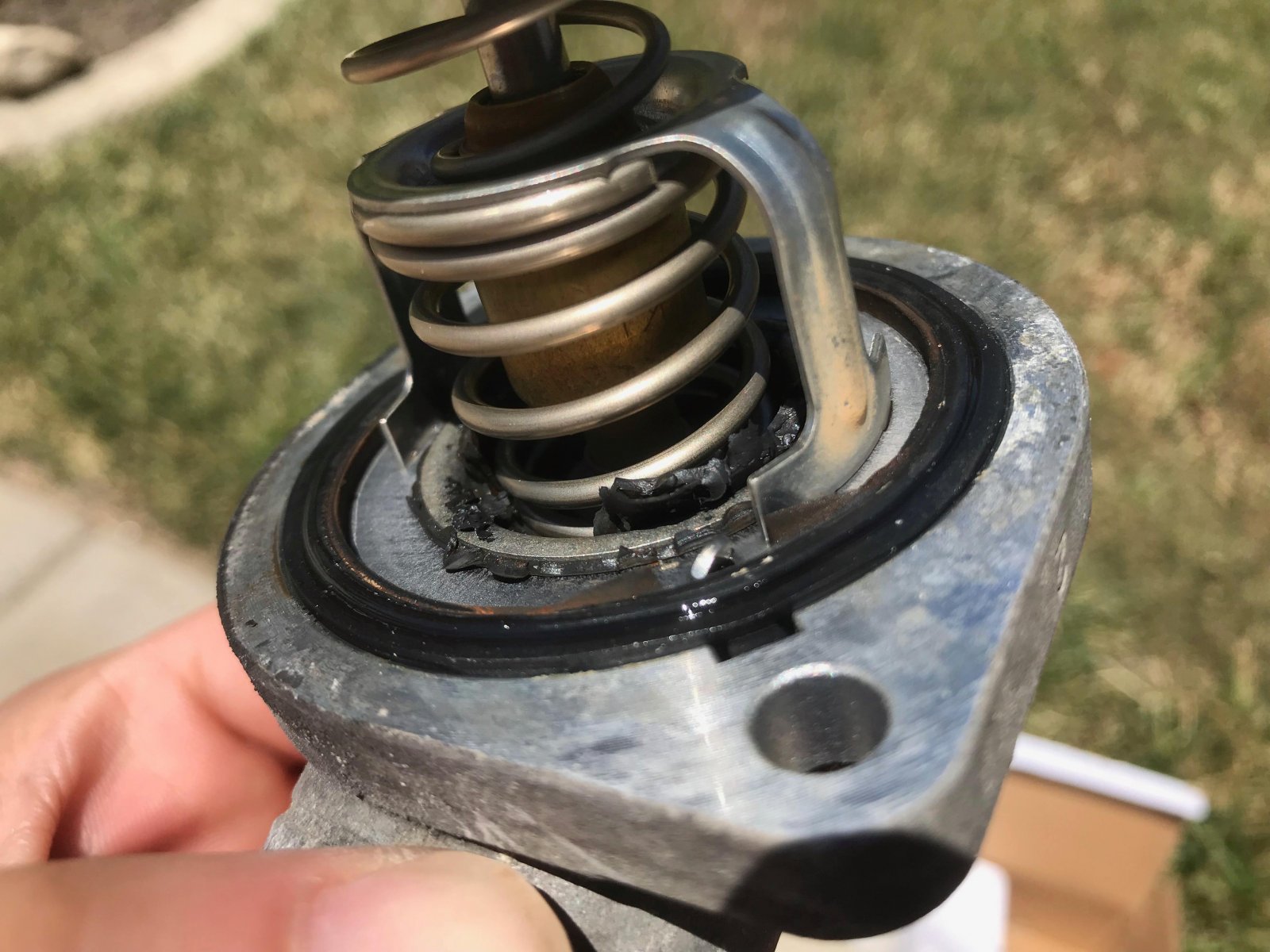

Old thermostat:

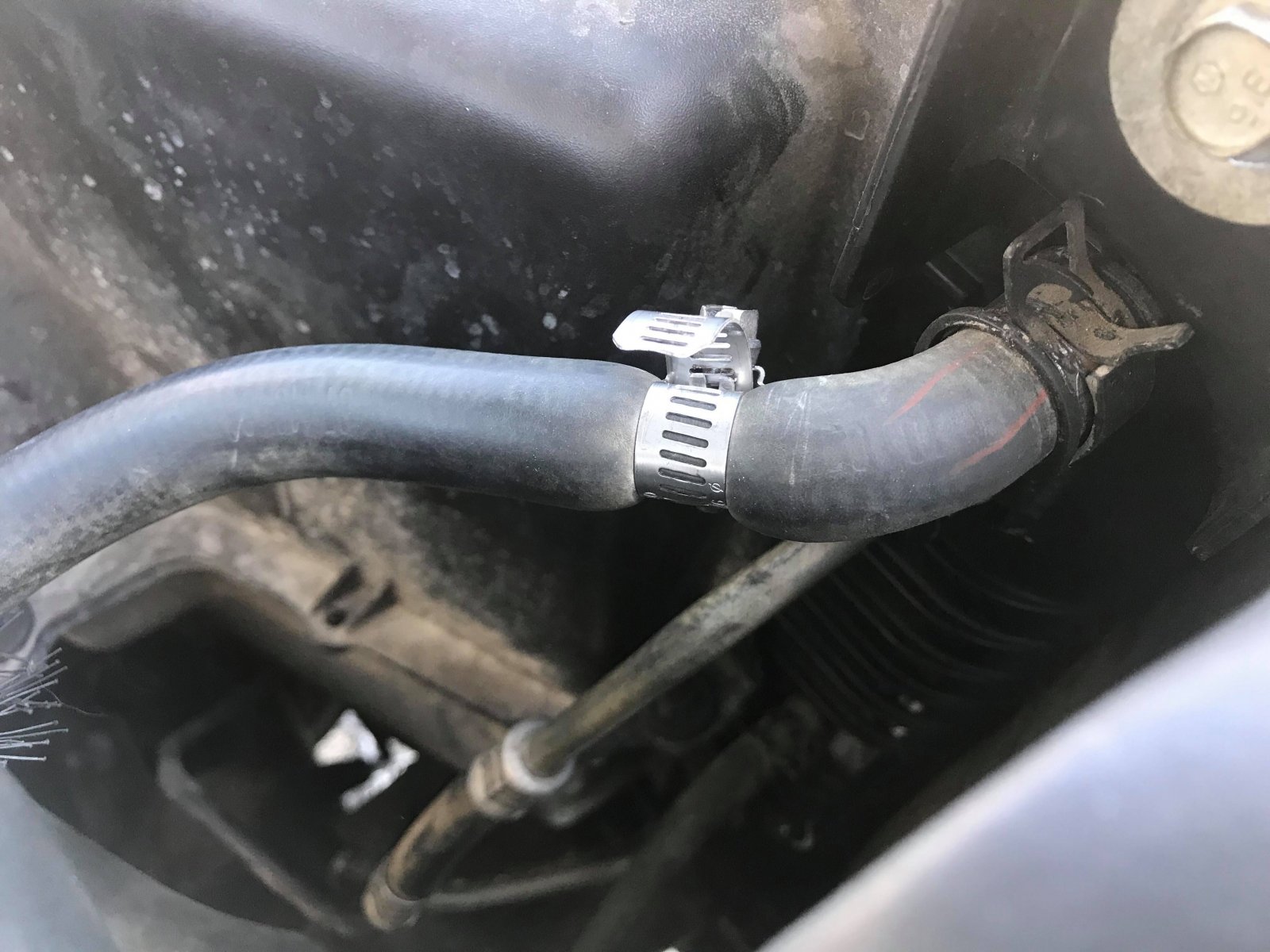

Stewey956
Apr 24, 2019
17
Not pretty, but it did the trick. Was able to reach 205* or thereabouts.
My only concern now is restricting it too much and causing some other malfunction.
S
Stewey956
Apr 24, 2019
17
Would be worth a trip to the plumbing section to find a more future proof method such as that. Thank you for the reference!
That is guaranteed to have you broke down along side the road at a future date.
The hose clamp will eat through the hose as it expands and shrinks.
