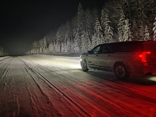

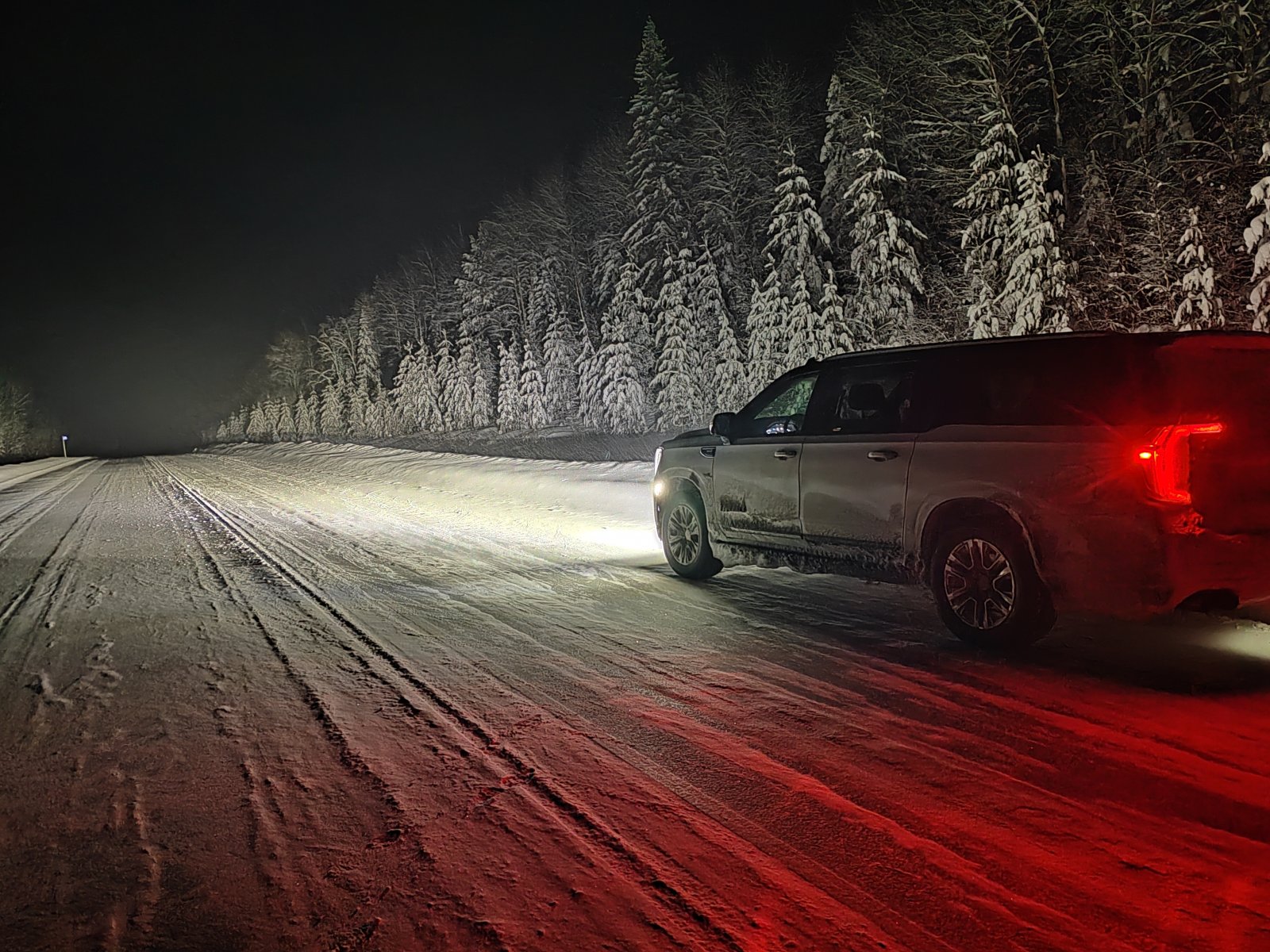

Holy cow!! That sounds awesome! I may have to visit when I can drive from one side to the other on a paved, high speed, road. Pretty neat stuff. I like progressive thinking, although I hate toll roads. But, I understand that 8000 miles of road isn't cheap to build or maintain.
What kind of fuel economy do you get driving like Mario Andretti? Also, what is your fuel cost in Russia?
Of course come))) we have a huge number of interesting places)) here is a photo, for example, in the Ural Mountains. On the border between Europe and Asia)) fuel consumption in the mode of 100-100 mph turns out to be about 11.5-12 mpg, and gasoline is similar to the American 91, in our country it costs about $ 2.7 per gallon

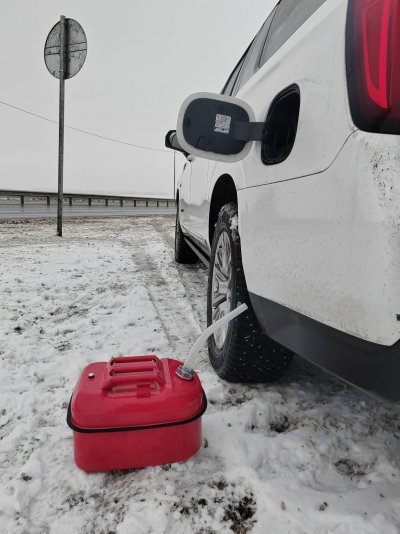

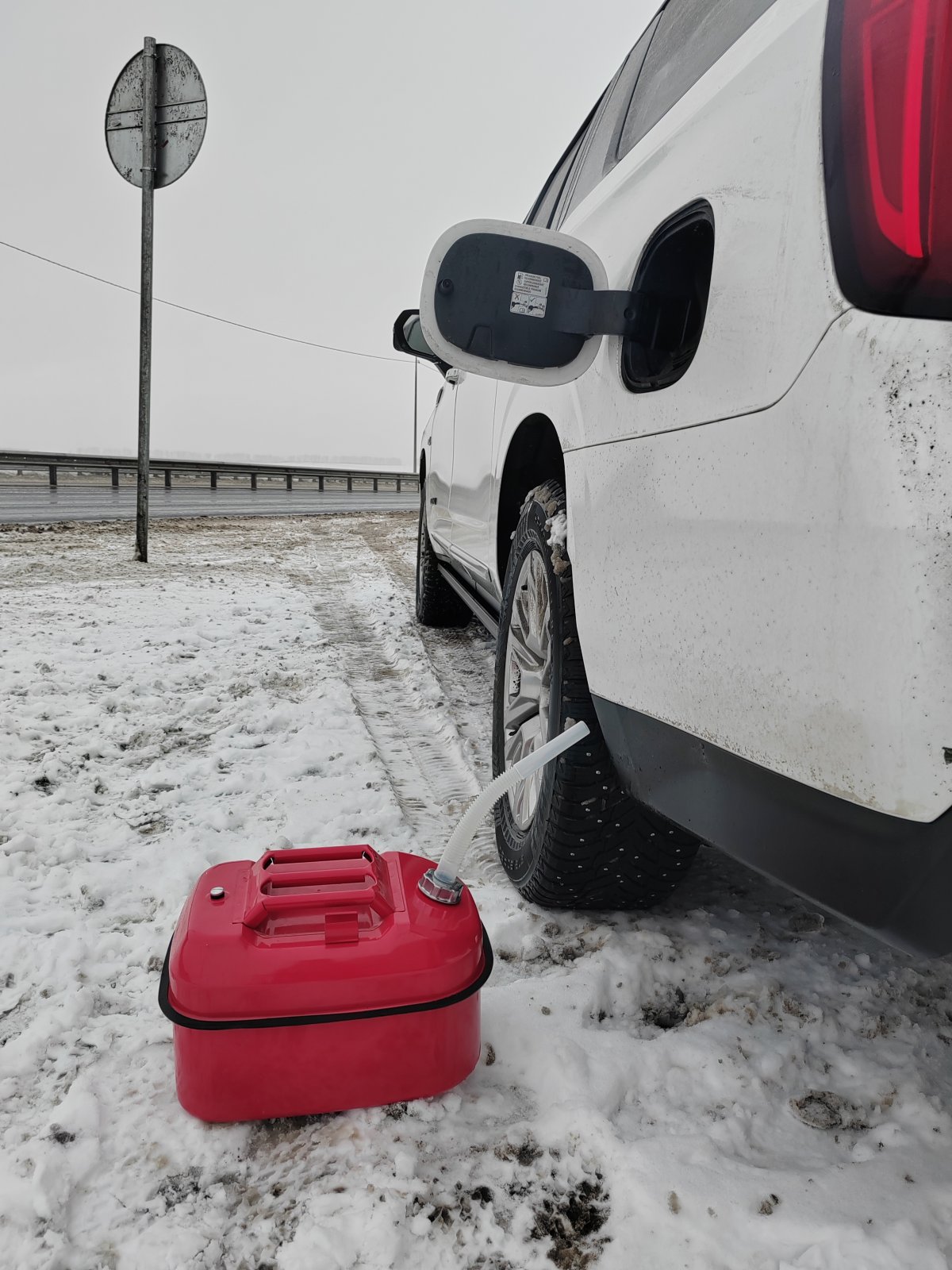

I would imagine fuel stations are decently frequent on those roads. Sounds great, I wouldnt mind cruising at that pace with hardly any traffic around.
Unfortunately, there are not as many gas stations as we would like, but they are developing, while you have to plan, and just in case, take 1 canister of 20 liters with you) just last year during the New Year holidays, it came in handy, when the flow of cars on this highway was so large that the queue was 3-4 kilometers. But based on the experience of other toll roads, all this will change over time. Again, no one prevents you from leaving the toll road, driving 10 km to a small town, eating, refueling and returning to the toll highway to continue your journey.

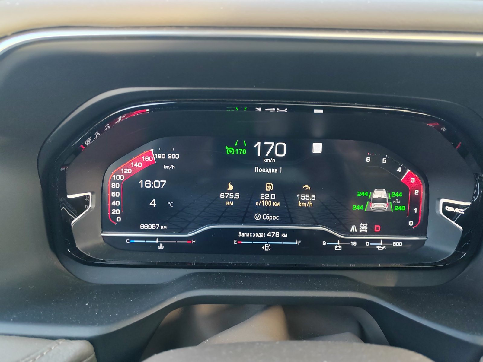

For example, here is my way, with an average speed of 155 km/h for 645 kilometers

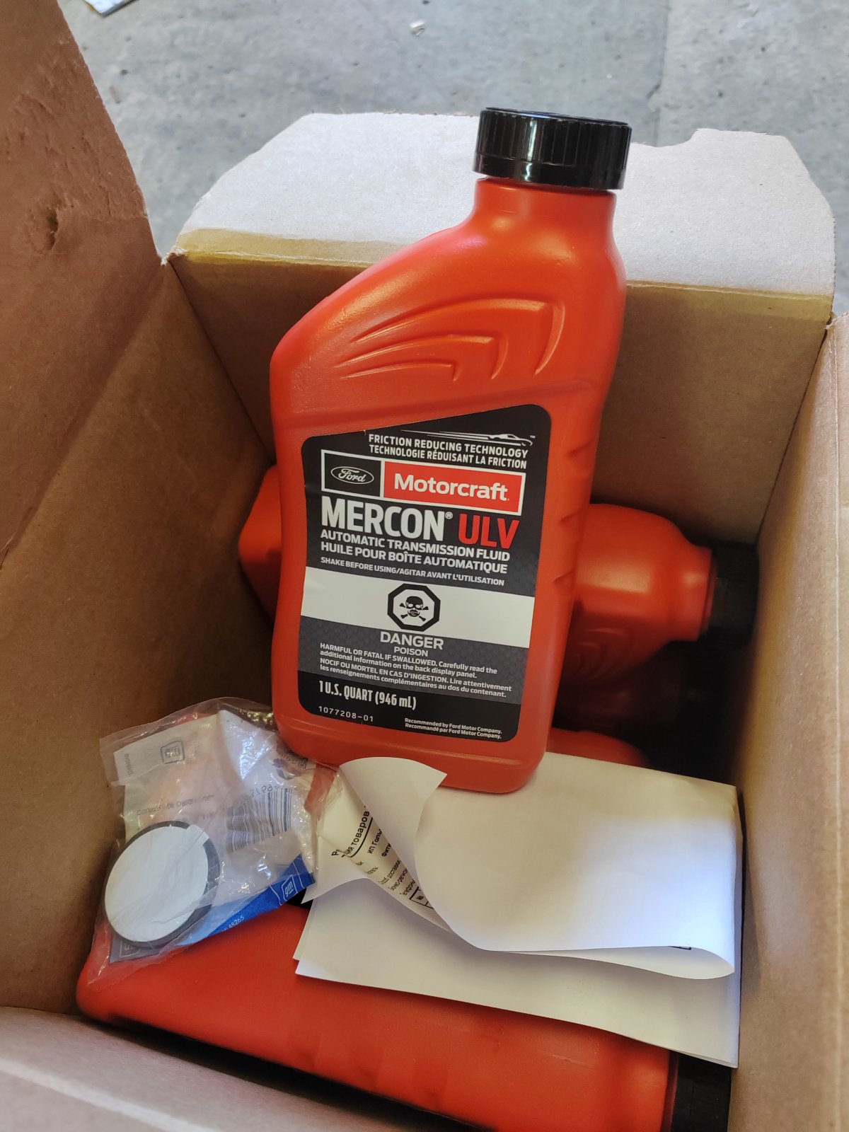

If you plan to keep your vehicle for a long time I would replace all the ATF before 20,000 miles. GM may set spec's but the bean counters are in charge of procurement and they will always purchase the cheapest that just meets the spec's. There are much better ATF out there then what GM sells. I would never put any lube with the GM logo on the bottle in my vehicle.
We have a 10-speed Ford gearbox. We pour Motorcraft liquid into it
Well technically you have a 10L80, which is the GM variant of the 10 speed that was developed as in a joint-venture between GM and Ford. The Ford variant is the designated as the 10R80.
I would assume the difference between AC Delco Dexron ULV and Motorcraft Mercon ULV is nil, since they are more or less the same transmission.
Badge engineering ...
