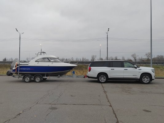

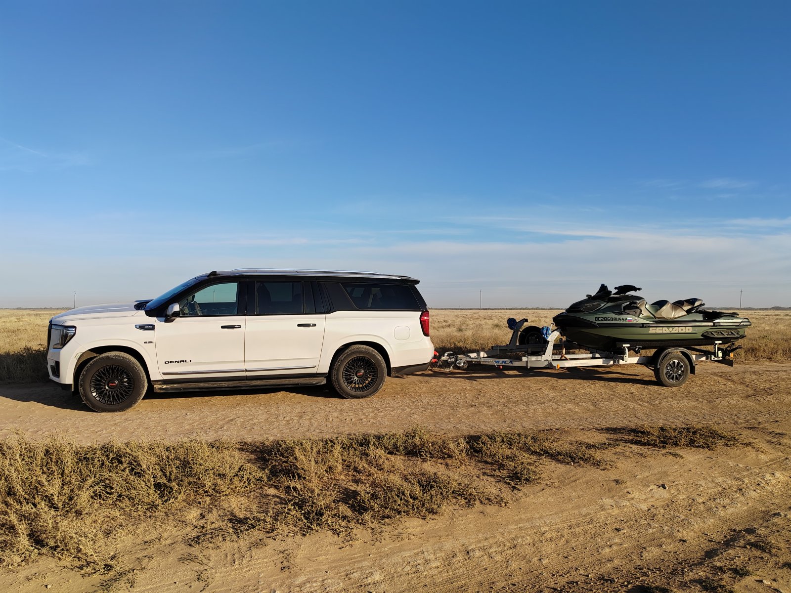

no, I drive at a speed of 100-100 miles per hour without a trailer)) with a trailer I drive slower))) if it’s a trailer with a jet ski, then the speed is about 85 miles per hour, if with a boat, then about 75 miles per hour)
