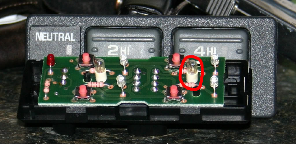

Hi, I'm new here but I came to ask a question.
On my Autotrac 4x4 selector, the bulb behind the 4Hi/4Lo switch has died. I already ordered the LEDs a few days ago (they are arriving today)
Thing is, I don't know how to remove the bulb. I will be replacing both bulbs but I feel that if I just wing it and try to remove the bulb, that it's going to break something.
Pic:

Welcome to the forum. Answered over at FSC, also.
You will have to de-solder them and obviously solder in the new ones. I am not even sure what type of bulbs those are but the NEO3 bulb should be able to work in there.
Yeah, GM is pretty stupid sometimes.

Thank you. This sucks, so I have (3) NE04 sitting here next to me and no soldering iron.
