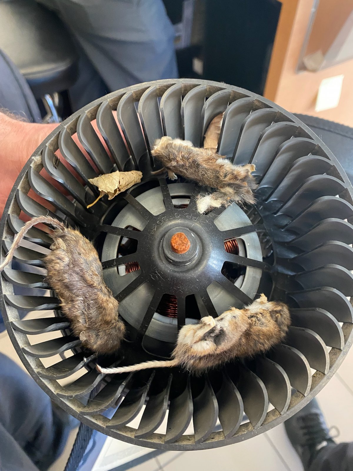

I finally found the pictured sent from the dealer after they cleaned it up.
