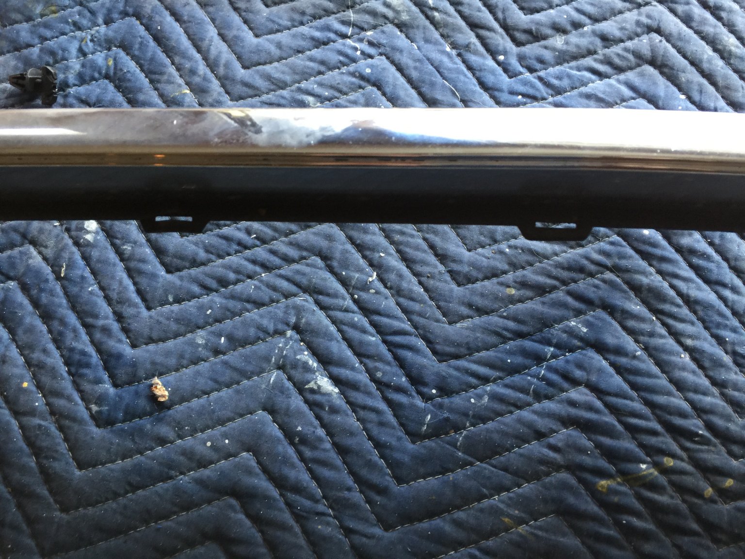

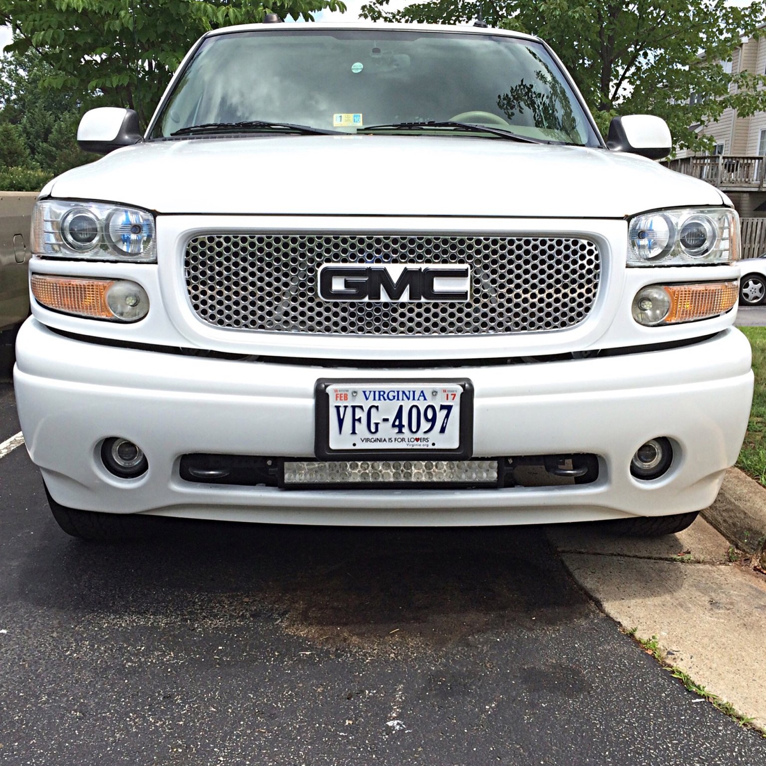

Nice looking paint, yeah I am in the same boat and deciding to do color match or not, have a white 04. My chrome is bubbling so i have to see what can fix that first.

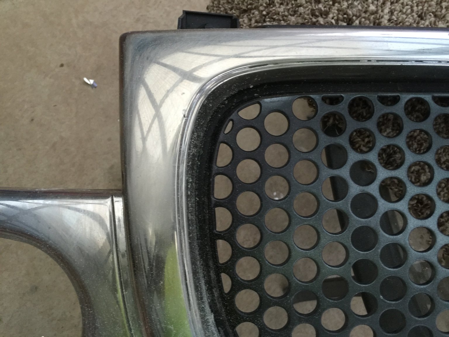

You can't fix the chrome on these grills. Believe me, if you go back in my thread you can see how the chrome is applied to the plastic. Once it starts to bubble or peel, you can't do a damn thing with it. Can't even strip it. I tried everything. I called the chrome shops. Since it's applied to plastic, you'll destroy the base plastic before you'll do anything to the chrome other than make it bubble more as the plastic goes to hell and becomes deformed.

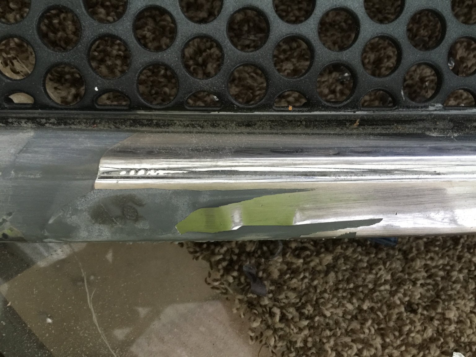

Thanks for the heads up, yeah i read through your post. Even though its not ideal i was thinking of chipping the loose chrome off and then epoxying the missing section to level it out at least and then prep and paint over everything. I know I will have to touch up as time goes by but that's to be expected when painting over chrome. One day I will buy a new OEM grill to paint but for now its worth a shot.

You could attempt to sand the bumps flat and then fill the pits. Chrome is hard though.

It will be hard to do; when filling in a primered and painted surface you have a bit of depth to feather it out but with chrome all you have is a sharp edge so you will see the edge of the patch.

I think i will have to take the lesser of the two evils by having that slight edge vs the bubbling of the chrome. Only time will tell how it will turn out.
