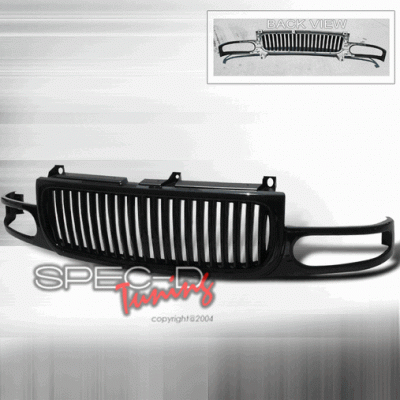

Another problem with these grills is that they're made of several pieces and where they are joined together, the chrome goes underneath the other piece and so I don't think stripping it is a good idea. Besides, I can't seem to find a surefire way to do it. I've searched everywhere for a paintable grill for the NBS Denali's but nobody has made one. The closest I've found is one that Spec-D used to make in black that I've heard can be sanded and painted but It's not OEM style but instead it's a vertical bars style. It looks to be discontinued but I found one online and asked to make sure the company I ordered it from has it in stock. My plan is to remove my stock honeycomb center and install it in the center of that one. I'm planning on having the main grill colormatched in pewter, the honeycomb to be done in black (which will have to be a rework of the chrome OEM one which I plan on sanding all the chrome off of), and the GMC emblem colormatched which I already did.01-06-gmc-denali-front-vertical-grille-black-9.gif IMG_4879.JPG

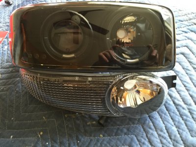

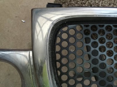

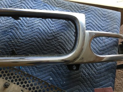

Oh well looks like this project is screwed because even though I contacted them and SPECIFICALLY ASKED if they have that Spec-D grill in stock, they just called me to say they made a mistake and it's discontinued and they DO NOT have it in stock. F^#k. Back to the drawing board. At least I got my new headlights and corner lights even though they're not going in until the grill is painted. IMG_4872.JPG IMG_4873.JPG IMG_4875.JPG IMG_4872.JPG IMG_4873.JPG IMG_4875.JPG IMG_4883.JPG

@YukonXL04 I'm starting to think that's the way I'll go. I may not have any choice! It's weird, if you think about it, that there would be a problem just sanding the chrome as opposed to sanding any other plastic part, like I did to my appliques. I may use the muriatic acid method first. If you look at one of the pictures in my first post, you can see where the finish is a bit dull. That's where I left a rag soaked with the acid on and it seemed to remove SOMETHING. The chrome shop dude said that's the actual chrome being removed. That's pretty easy to do also.
