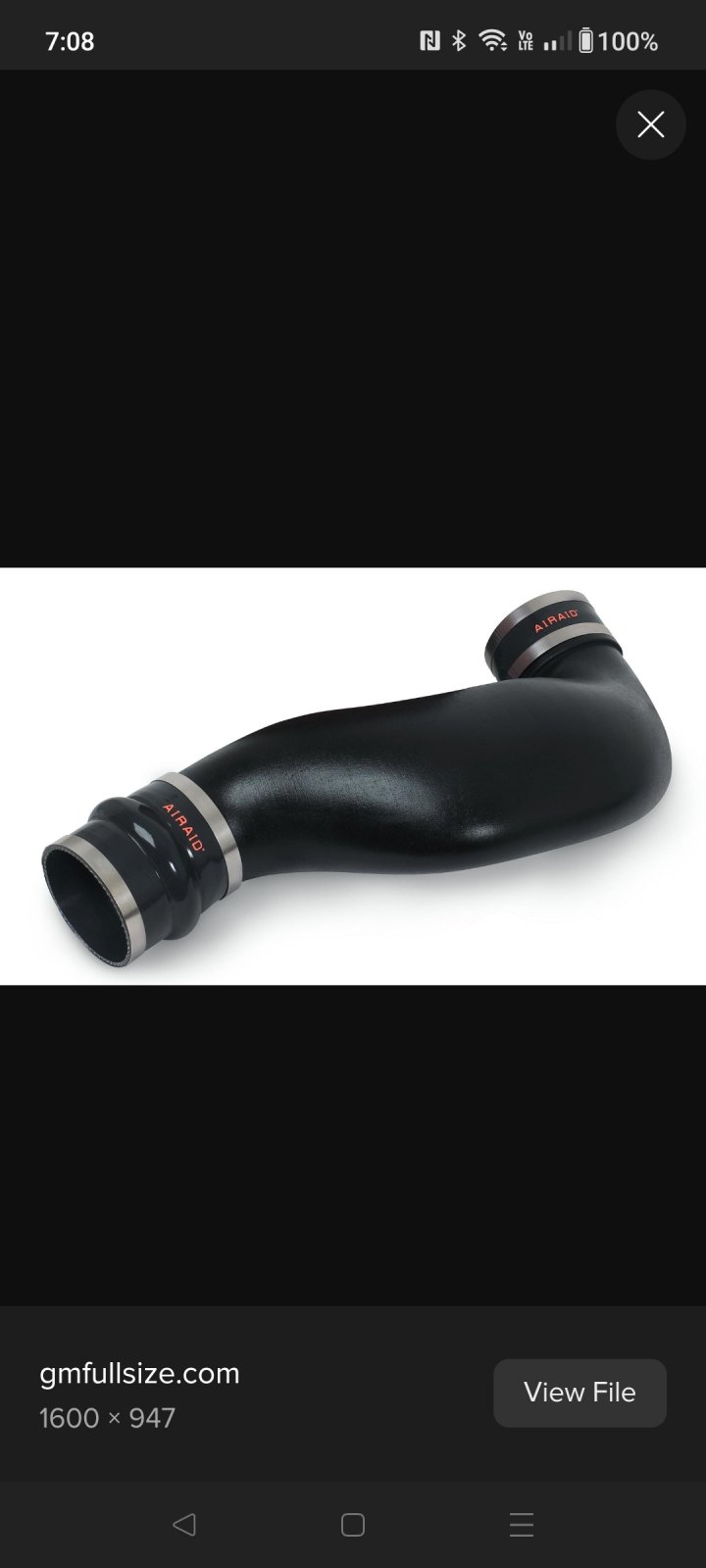

Good to know! What's the MIT thing?
It connects to the factory air box

I’ve heard a lot of good things on using the airraid MIT tube with the stock “box” as stated above any open cold air intake will actually suck hotter air then the factory in closed box.some company’s make sealed off intake box’s maybe corsa is one? I can’t remember. I’ve ran the cheap spectre ones from advance auto and I got a k&n on my Tahoe and a k&n on my Silverado and I’ve never had any problems out of them!
But again if you can find a closed box intake or even just using the stock box with a k&n drop in filter with the air raid tube has been proven to make great gains

No bling? Then, for performance, you'd be all set with a substantial seal between the filter box and fender and maybe a good filter. But, there's really nothing to be improved beyond that. The foam seal is the factory setup's only real fault. It's thin and deteriorates with age then falls in and allows some of the hot engine air to be inhaled. I replaced mine with some Frost King 2.25" square weather seal- about $8 at Lowe's. My IATs in start-stop traffic are 1-5° above ambient at most. Of course, they rise when idling for a long time, but that's to be expected. Even then, it's not a whole lot. They quickly drop once driving again. Cruising on the highway, the IATs will match ambient. You can't get any "cooler" air than that, and it's under $10.
For sound, anything that loses those muffler chambers (Helmholtz resonators, if you wanna be a nerd about it) will increase the intake sound. I'm a fan of the Airaid MIT. It's simple, relatively cheap, easy to install and looks good. The intake sounded so good on mine that I bumped a louder muffler further down my list of mods. If you're crafty and on a budget, you can make a considerably good-looking intake tube with PVC or ABS pipe and appropriate rubber couplings from the plumbing section. Some nifty gluing, sanding and painting and only you would ever know what it actually is.
