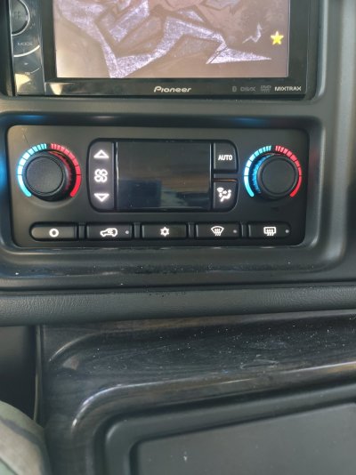

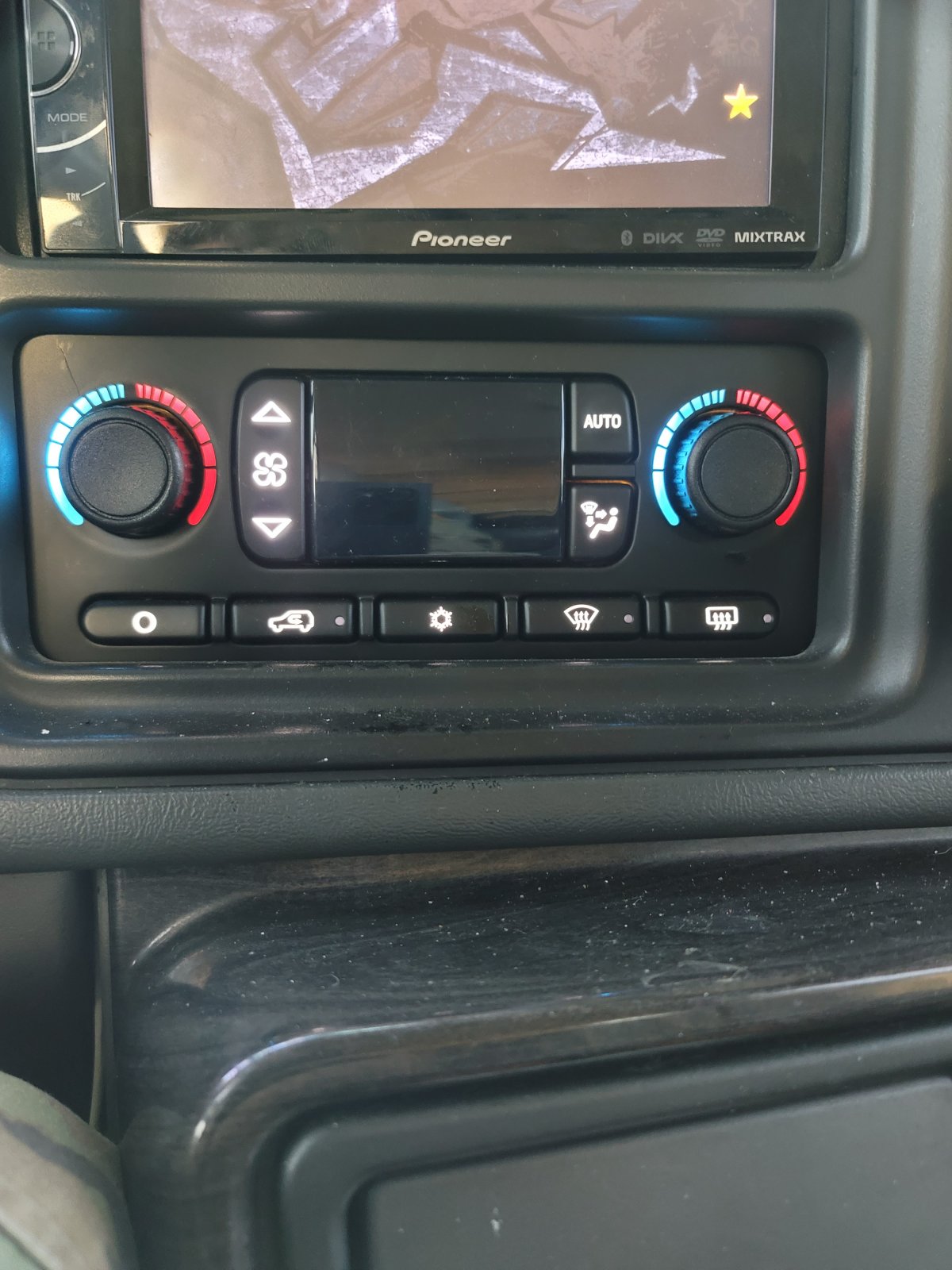

Hey all. Sorry I'm asking this but I've searches and can't find an answer to my exact problem. I replaced the climate control module on my 2003 yukon xl denali back in October. Well recently it seems to of lost power but the back lights still light up. See the pic for what I'm talking about. Checked fuses and all those are good. Got another one and same issue. Not sure if it was bad out of the box or a wiring issue. Any help?

Have the two Climate Control and HVAC fuses in the Instrument Panel Fuse Block (in the cab) been verified as having voltage on both sides of each fuse, with the key on?

I only checked the fuses. Didn't put a meter on them. I figured if the buttons are still lighting up it's getting some kind of power

This may be long shot since this post is old, but i’m having the same exact issue right now and i’ve gotten to the point where all fuses are good and tested with a light. Has anyone got a fix for this?

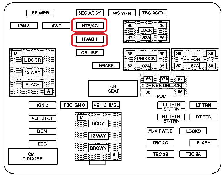

I have a 04 gmc yukon slt 5.3 and I have the same exact issue. Found a 1.2 Amp draw coming from hvac/ecas fuse under the hood. That's for the climate control module under the radio. I have to check htr a/c and hvac 1 fuses to see what else I run into..
