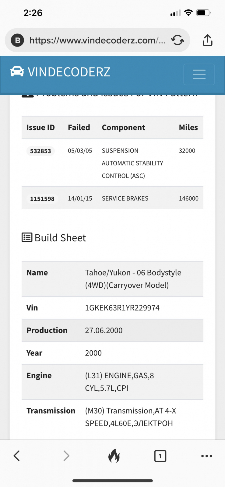

2000 Yukon Denali 160k direct injection weird carburetor thing I don’t think it’s flex fuel , zero codes ,L31 5.7

Info about your rig? Year, miles, flex fuel or not, maintenance history, any codes showing up with a scan tool?
Ah. It's the pre-LS "Vortec" tree-fiddy. Definitely not direct injection. It's a throttle body mounted like a carburetor with all the injectors inside the intake manifold with little nozzles that shoot the fuel into the intake runners. So many possibilities for a misfire on these and many that the PCM won't "see" unless it's really bad and, therefore, not throw a code. Can you get your hands on a scan tool that shows live data? How about a fuel pressure gauge?
