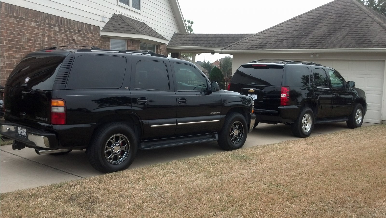

Wanted to ditto the 6 sp tranny, I replaced my 2000 Tahoe with a 2013 and love the 6 sp. I also agree with
intheburbs that you need to address the AFM and get that truned off , there are several tunes you can get to do this. I used Diablo Sport I3 but anyway enjoy your 2013.
