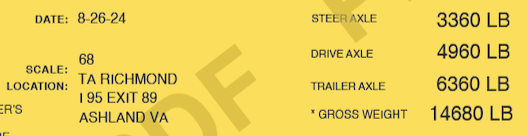

Picked up the camper today and stopped by the CAT scales. Got a reading with just the Suburban with a full tank of gas + me with my father-in-law on board, plus some tools in the cargo area. Then got a reading with the camper hooked up. I messed up though and forgot to put it in neutral without the camper attached, so my steer axle is probably 150 lbs high in the first image. I had it in neutral with the camper attached in the 2nd image though, so that should be accurate. Note that I did NOT weigh it without the WDH bars engaged. Clearly they're not doing much right now, which I expected given the increased hitch height of the 3500HD. Doesn't matter though - I'm not even close to either GAWR, which is 4900 lb front, and 6200 lb rear. Doing the math, the trailer is coming in at the exact same weight as the truck itself - 7340 lbs. Subtracting the trailer weight from the trailer axle weight, I calculate 960 lbs. on the tongue, which is about right with all holding tanks empty.
To all of this, we will add about 500 lbs of kids and dog this Thursday to go camping.
This is great info Geo! Dang, these trucks are heavy.

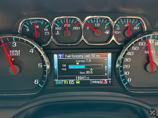

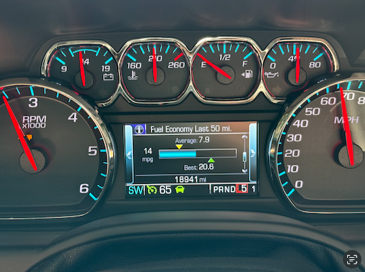

Drove the 3500 down to Mill Spring, NC for the Earl Scruggs Music Festival, about 800 miles round trip, hauling the camper. Such a pleasure to tow with this thing. My wife commented on the way home about how safe she feels in it because she knows it's so solid. Can't put a price on that.
We lucked out and got headwinds both ways. :p Gas mileage averaged right at 8 mpg - sometimes more, sometimes less, depending on speed and terrain. But we did have a minor issue pop up that went away just as quickly. On the way down about 100 miles into the trip, the fuel gauge suddenly dropped to zero. No low fuel warning light or chimes. We stopped at a rest area and I looked everything over to make sure we weren't in fact dumping fuel, shut it off and started it back up, but the gauge remained on E and the miles remaining to empty screen was reading "--". But the average fuel economy screen still worked so I calculated our next fuel stop accordingly and we made it just fine. After fill-up the gauge was working again and continued to work for the rest of the trip. My guess is after sitting so long under prior ownership and then sitting in our garage for several weeks, the fuel sender was sending out enough odd information that the computer shut it off. But who knows - I'm just glad it's working again.
Other than that, everything was great. It was 96ºF outside with full sun on the way down, and transmission temp hovered around 190ºF, peaking at 198 after a long-ish climb. On the way home it was in the upper 70's outside and the transmission hovered around 180ºF. The coolant temp gauge never left the 210 peg.
