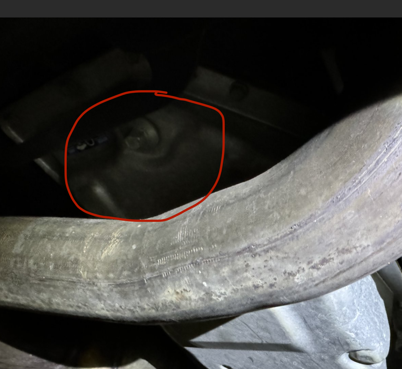

Thank you! Looks like it has a transmission drain plug too.
This by itself is a huge win for servicing these trucks long term. Everyone’s opinions and insight is super helpful!

I don’t believe it does. There’s a fill level plug on the highest level of the pan, but that’s the closest thing to a removable plug.
Are you sure? Unless I am looking at the wrong part and this is the engine oil drain plug…?
30,773
48,479
That’s not in the lower portion of the pan. As far as I know, that’s a fill level plug.
I would slap one of the Holley B&M deep pans on there have it on both of mine. add's a couple extra quarts capacity and some cooling, drain plug
just have to fiigure out which one I think the 6l80/6l90 pans are each different maybe
shows no match for the 3500 but I bet you could just go by the transmission model, I don't think there is anything in the way versus a 1500
to install the exhaust may have to be loosened up as a little extra room is needed to get the pan on.
magnet is just transfered over to the new pan from the oem
That’s a good call since it’s primarily a tow rig. I’ll look into it.
