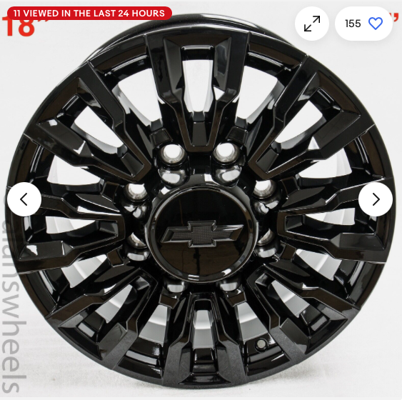

Doing a little wheel shopping and have landed on these as a good complement for the Tungsten Gray paint color of the truck. Probably won't order until the spring so I can start the 2025 towing season with a fresh set of tires. Amazingly, the tires that came on it have zero dry rot or blemishes of any kind, despite having mid-2017 date codes. I credit the climate controlled storage the truck was in. For tires, I will likely go with the Michelin Defender LTX M/S 2 in the LT265/70R18 size. It's about 1" bigger in diameter than the factory tires, but should still clear without issue. There are way more options than in the 265/65R18 size.

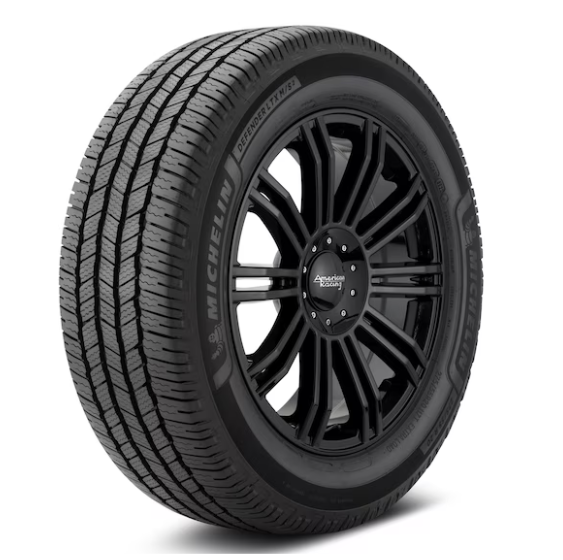

Those will look great! I will be the first to tell you tho please be careful when towing in those tires. I have a small fleet of vehicles and most sit in climate controlled garage but a few yrs back one of them was needing some love and I put a fresh set of tires on it (I think they were about 6yrs old) and the difference was night and day. The old compound was extremely hard and brittle even tho it visually looked fine.
The Michs are good tires. I have run them before.
Good call. Thanks for sharing your experience with it. I’ll get them changed out.
