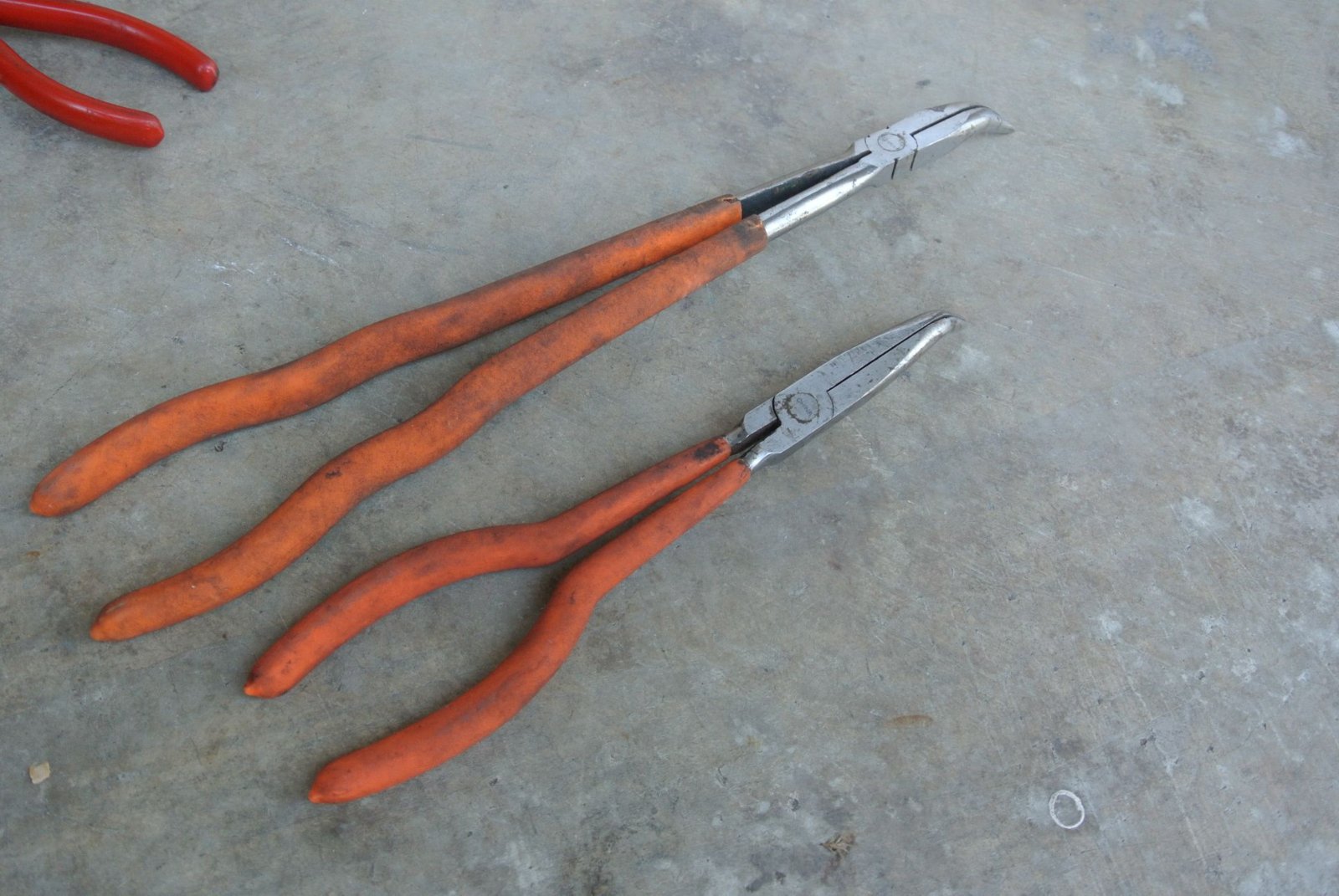

bought a set of 3 pliers at harbor freight like 10-15 years ago, cheap but they work very well for situations just like this
