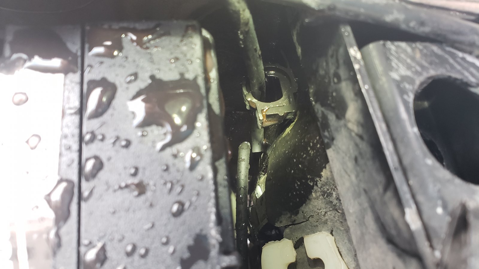

Jobi-Wan Kenobi
Jobi-Wan Kenobi
Aug 27, 2022
236
308
Found the leak. I think I broke the line when I was changing my battery a couple weeks ago.
