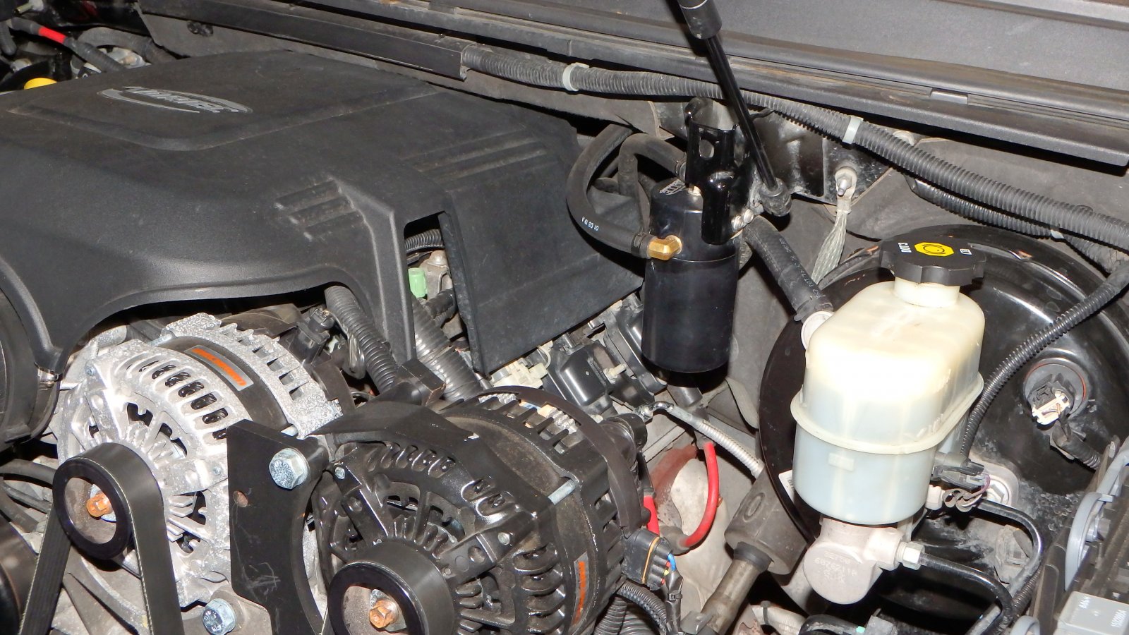

I do have a DR-44, actually just replaced it.
I may get one of these as when the cooling fans come on, there's a significant momentary voltage drop until the system can catch up.
I run the DENSO 220 as an upgrade, My DR-44 sit's under the hood on the tray at the front of the drivers fender in a tool bag just in case i need it. I upgraded for the exact reason you mentioned, I upgraded the electric fan motors from 500 watt to 700 watt and when they kicked on high it blanked out the bose stereo. 700 watt motors can pull 55 starting amps each when they cycle to high. Didnt hurt the bose but two 700 watt fans was overkill so i opted for 700 watt driver side and 500 watt pasenger side and this combo works perfect. Hot engine cooant enters the radiator from top hose drivers side which is my reasoning for running the big fan motor on the driver side.
Got a link to the alternator you are running or what vehicle it is for originally???
Also do you run a shorter belt with this setup or is it necessary?
Thanks

The first one i got was from an east coast salvage yard off ebay, 220 Amp Opt KW5 ID 22949466 Fits 15-18 SIERRA 2500 PICKUP but it had alot of surface corrosion probably from salt on the roads. So i bought a new "china junk" DENSO 6860 knockoff from DB ELECTRICAL for $135 shipped. It had a 12 month warranty and is still going strong, This alt new OEM is around $700! I dont like china stuff, But so far so good and i do carry the spare DR-44 which can be R&R in less than 10 min. Yes 1/2 inch shorter on the belt and the tensioner indexer is 1/4 inch to max tension. In the summer it will still gather a little belt dust at the front of the alternator just below the pulley which defines how much tq is being used to spin the alt at idle. It only does this in the summer with cooling fans/max ac/stereo/dvd all going at once. I am happy with the setup, The DERALE trans cooler also has a remote fan so this vehicle needs DC current to be reliable but even when towing in the summer my trans temps/coolant temps are no longer a concern.

ACDELCO PN-15-80881 Rock auto sells them. Understand IMO the stock alt cant support these fan motors at idle without a minimum of an overdrive pulley being added to the DR-44 160 amp. two 700 watt fan motors cycling from low to high can pull as much as 110 amps momentarily until they get up to speed. I also advise replacing the plastic fan/fans if you go to the 700 just to insure you dont grenade a brittle old fan from the 500 watt stock motors also oem from rockauto 5 and 7 blade. 700 watt motors move an enormous amount of air but require an enormous amount of current to do it. IMO they are not plug and play and require an alternator upgrade.

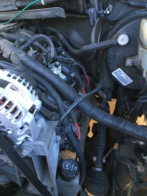

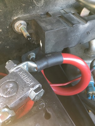

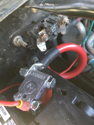

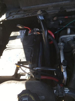

Got it done this weekend! Took about 2 hours and looks good. I was starting to have some strange shifting the last couple of weeks and that seems to have cleared up, the "flicker" at about 1000 RMP is gone, my headlights are brighter and overall my idle and acceleration are smoother. So I am confident the upgrade helped! Next I will upgrade the wire from mega fuse to alternator and get a new factory wire for the mega fuse to fuse block.
Recap of what I did:
- New battery terminals
- 1/0 from Battery to Mega Fuse
- 4 AWG from negative battery to frame (added)
- 4 AWG from negative battery to motor (replaced factory)
- 4 AWG from motor to firewall (replaced factory)
- Kept factory ground from negative battery to frame (smaller wire)
With about 30 miles of driving I am happy with it. I will post updates if I discover any further pros/cons.
