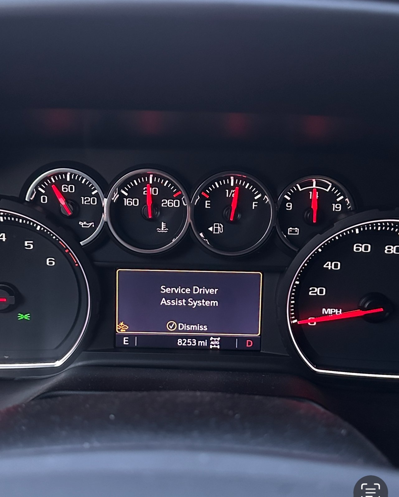

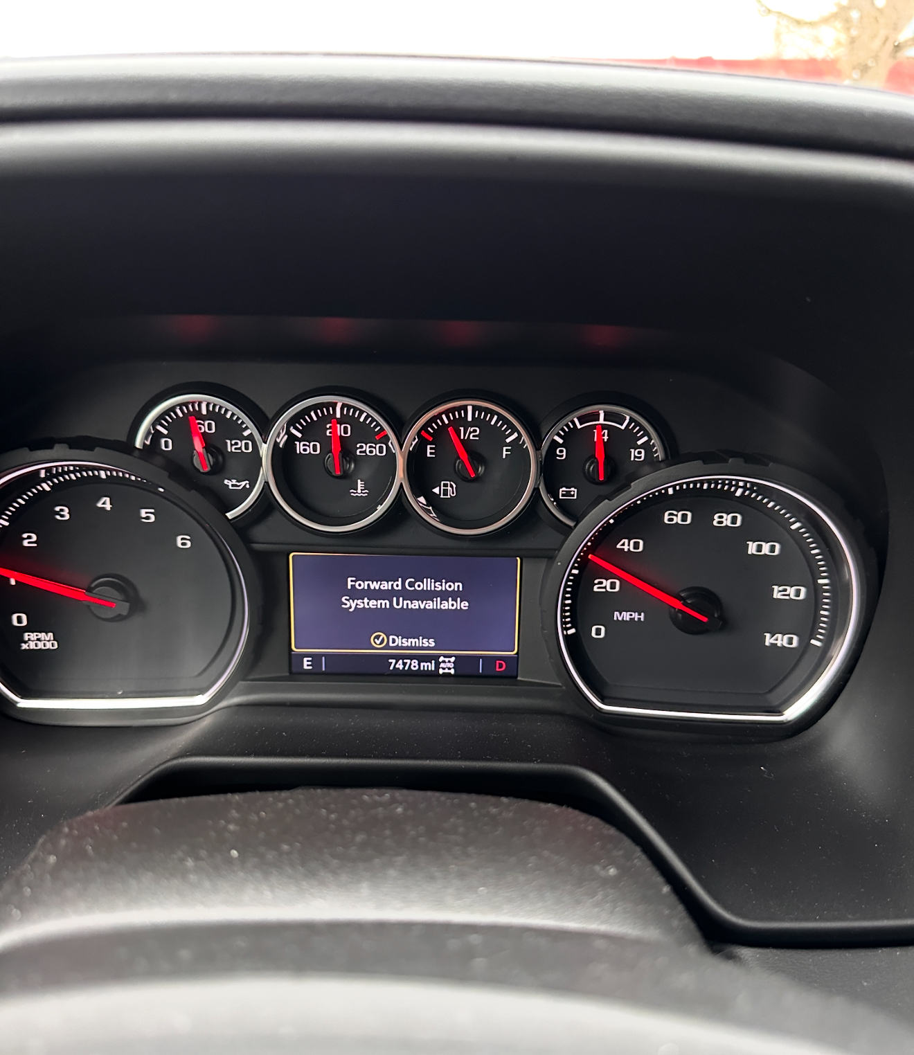

For the 2 months or so, every single time after 15 min of driving the following warning signs come on, and won't turn off until I turn off the car and start again.
FOWARD COLLISION SYSTEM UNAVAILABLE
SERVICE DRIVER SYSTEM ASSIST

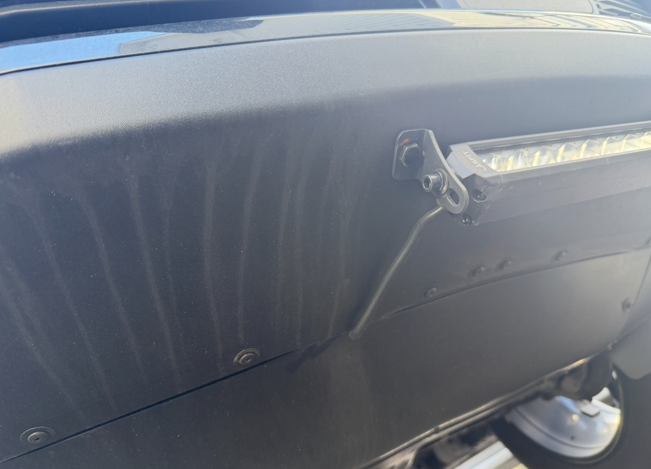

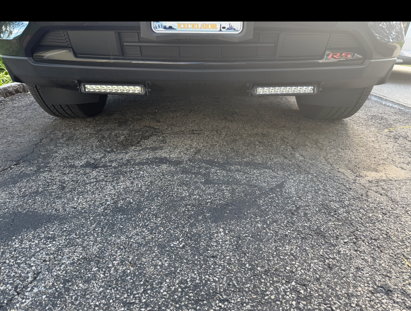

- 2 Front LED bars (hardwired directly to battery) mounted underneath bumper, see attached photo.

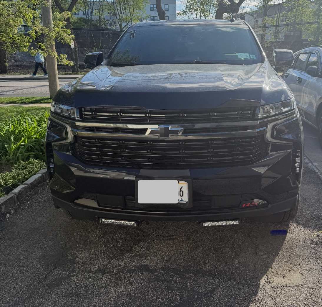

- I also added a front bumper license plate protector (BumpShox) not sure if that's blocking anything. See attached.

I don't know exactly where the sensors are located on your model year, and it does not look from the photos that you are blocking anything.
Someone more familiar with your model year will chime in.

There is radar in the lower front on the left, think right in front of the driver, plus all the parking sensors in the bumper. Probably can figure it out if you go to the GM Parts catalog and look up bumper.

One of the rectangular plastic covers. Approximately where the tow hook would go. I believe that’s where the sensor is located.
