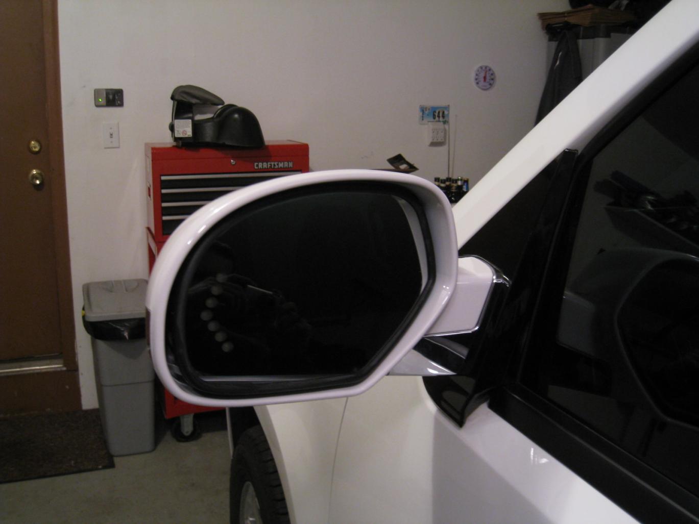

Here are pics. The gap where the Esky trim would go is actually not as noticable as it appears in the pictures. I'm very picky, and it doesn't bother me much. I'm mulling options of how to fill that gap. I may end up doing nothing.
I wish Tahoe/Yukon door panels were the same as Escalade door panels, that way we could buy the trim pieces and have that all work perfectly. :)
However, Escalade door shells are made differently just to fit that trim piece. If you put those on a Yukon (even Denali) it'll stick out and look funny.
If you come up with a gap solution, let me know!

I just ordered the chrome lower caps off ebay & the white uppers (since my LTZ has the chromes) I guess i'll have to wait to see the difference but I couldn't tell much by those pics of the esky mirrors? the upper whites cost me $75 shipped brand new from GM the lower caps were $49 shipped.. I also ordered the esky roof rack should be here smoetime next week (that was $304 then i have to get the end caps painted)

here's the pic from the place i ordered the lower "Escalade" style cap. i think the only difference is the chrome extends to the "stationary" part of the esky mirror whereas the chrome cap i'm getting doesn't? can someone post a side by side maybe? i'm curious to see if i want to go this route or find me some esky mirrors?..

I had those lower caps on my stock Denali mirrors. I didn't like how it left the part by the door black. My car is white, so it stood out. Also, the caps I got fit like shit. There were big gaps at the outer edge of the mirror. I'm picky and it drove me nuts every time I got in.

i will let u know when mine arrive. If they don't fit well enough i will return them. As for a gap in the esky mirrors? i can't even spot it from your pics so i think that is a non-issue for me.
Mr. B i was wondering if by any chance do you think i could use Original 2011 Escalade Chrome Window Trim on 2011 GMC Yukon Denali in order to Cover this little Gap that exists when you Install Escalade Mirrors on GMC Denali. Please let me know what do you think
Wod -- This isn't an opinion issue. It simply won't work. Take a look at an Esky door when you get the chance, and you'll see that the shapes of the doors are different (and that the trim pieces are not just sills, but integrated window-opening pieces). You'd have to swap DOORS in order to use the Esky window trim.
