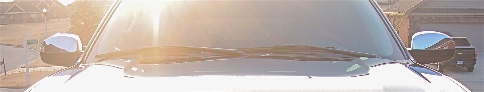

Sophomore, where are the pics of you mirrors? From the front of the vehicle?

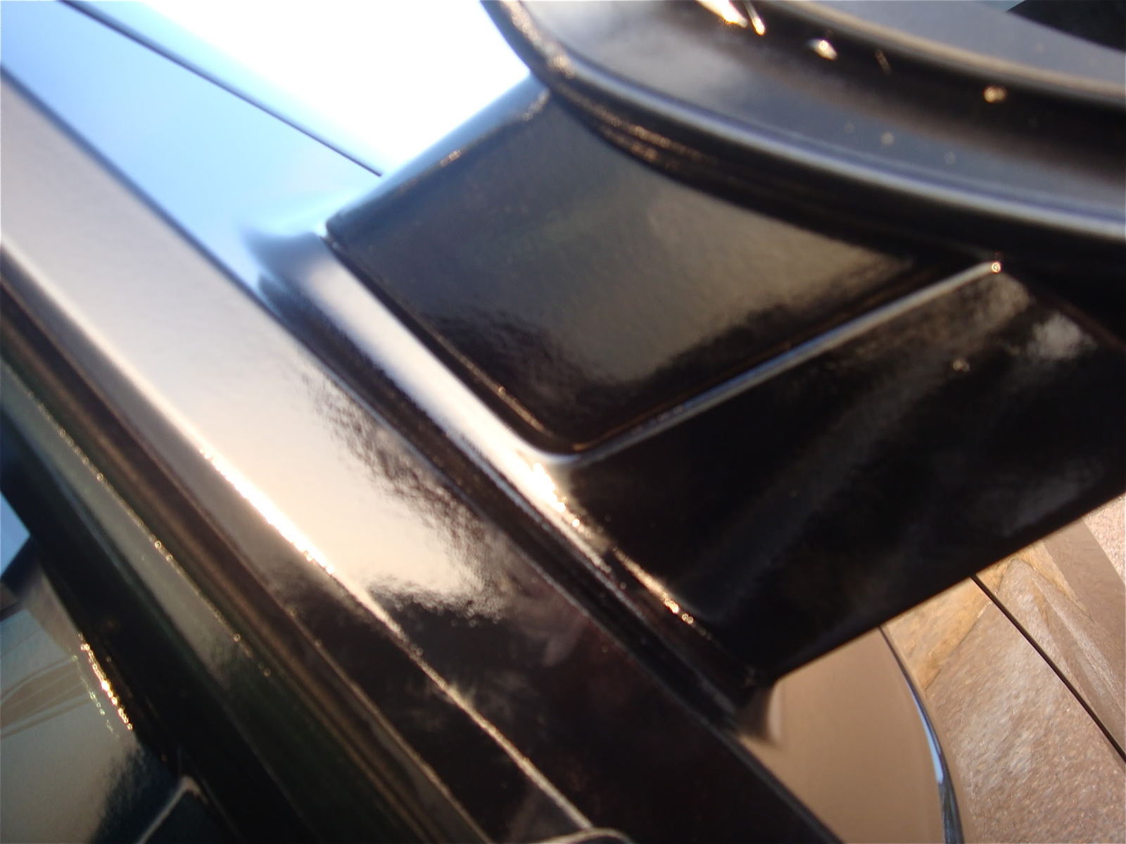

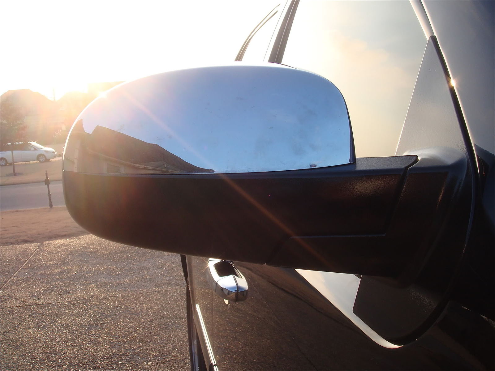

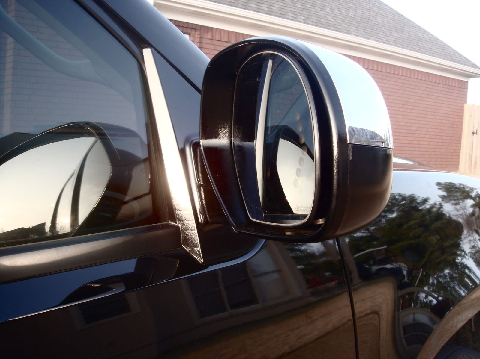

My bad! They're okay, with black they're not really worth the job but if you had a different color Tahoe/Yukon then they'd definitely be worth it. Pics:
