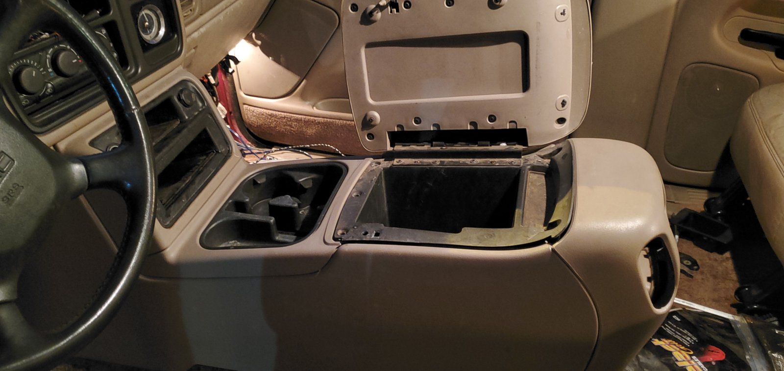

Hey guys. Was wondering if any other of the NBS center consoles will fit in my 00 yukon?
We dont smoke and the ash tray area is kinda useless.
I really like the center consoles in the 03 and up models but they use a different module for the radio/rear hvac.
I will say that the rear radio controls no longer work in mine due to an aftermarket radio so it doesnt matter to me what the other console has per say. Just interested if they will fit and reconfigure how up front looks.

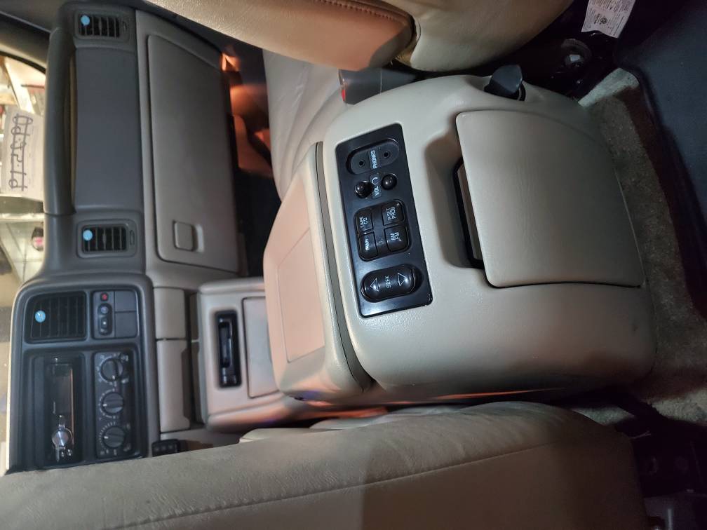

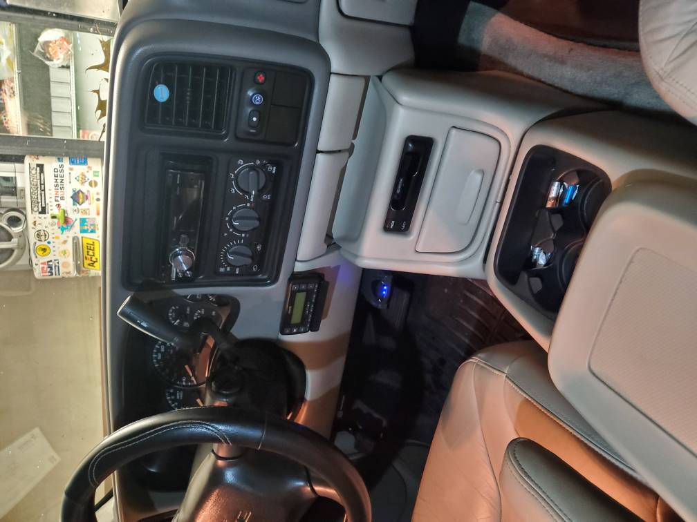

You have to change the glove box and lower dash surround in order to change out to the newer console. Just finished this on my 02 Yukon XL
