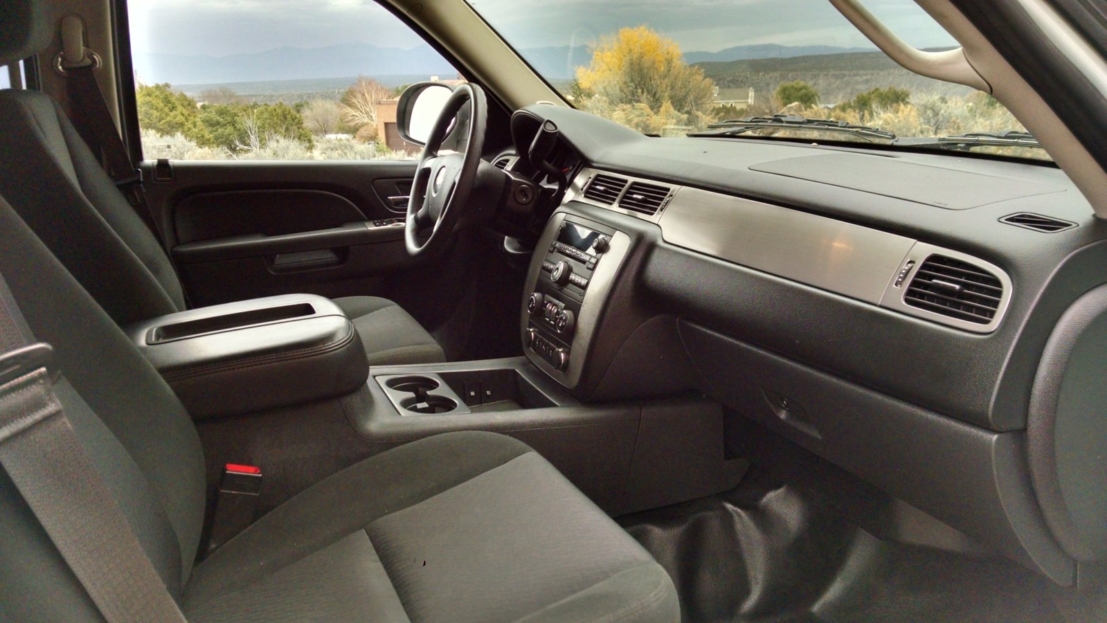

My ICE truck came with bench seats in the front so I get a cool lockable, hidden cubby with an extra 12v AUX power, 3 cup holders and a storage "bin".

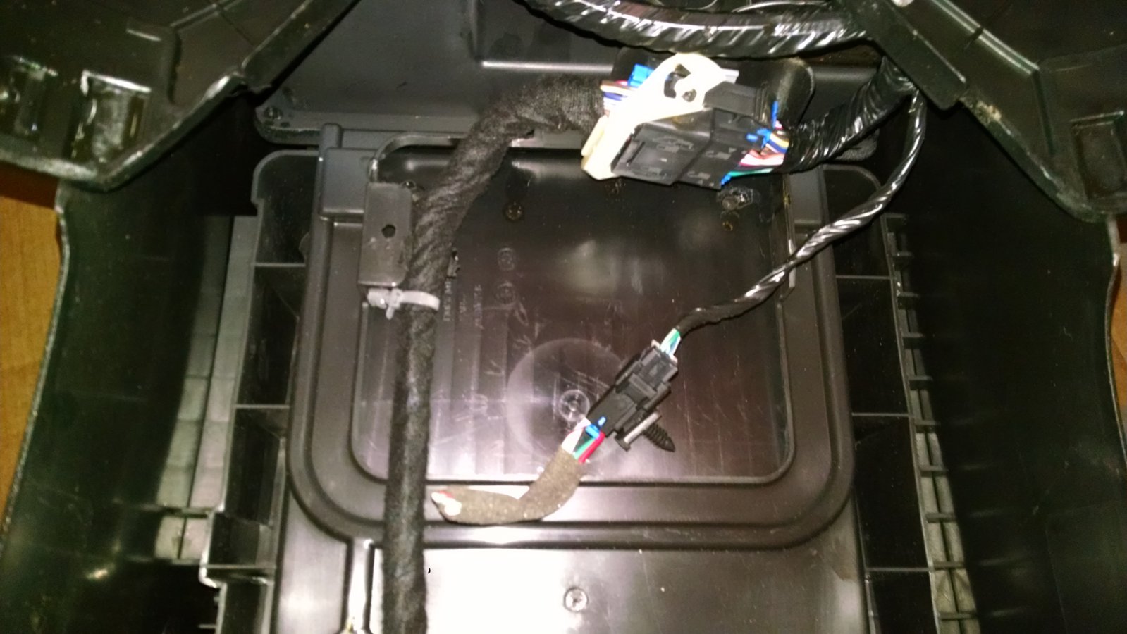

Ok, center console arrived today, there are two cables underneath that seem to be cut at the vehicle side.
It looks like the thinner one is going to be connected to the wire that I am supposed to fish out of the roll over sensor area? What about the other one (I know some said not to bother with it, but you know... curiosity) it probably isn't something that is in the truck already, so probably something that I would need to order, but then of course.... where does it go? anyone played with that?
