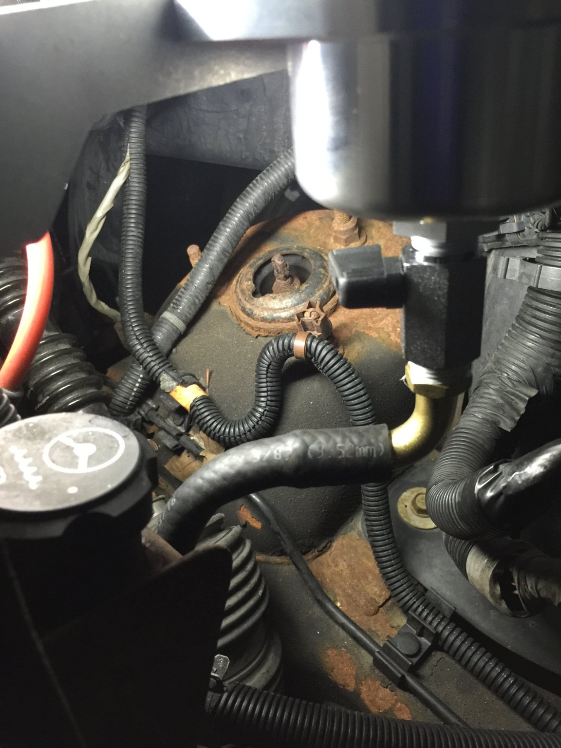

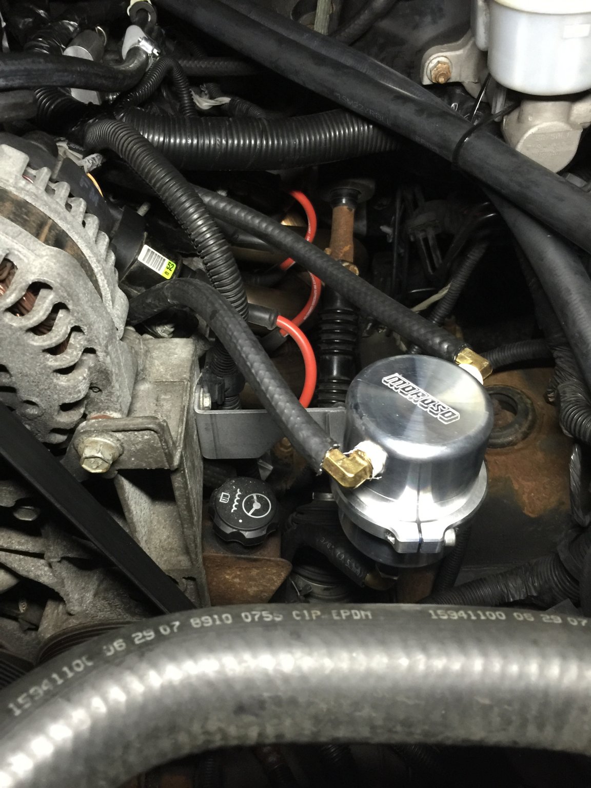

i run a moroso. Has a built in filter inside and has a drain to empty the can

I run a Mike Norris I got for $100 a few years ago on a forum group purchase. It took about an hour to install and that's because I chose to dig through my spare factory emissions hoses to find pieces pre-bent how I needed them instead of just using the hoses that came with it. It seems to be working just fine. I don't see why it would matter that your truck is a '16. If it has a hose somewhere that runs from the valve cover to the intake, you can (and should) splice a catch can in-line.
