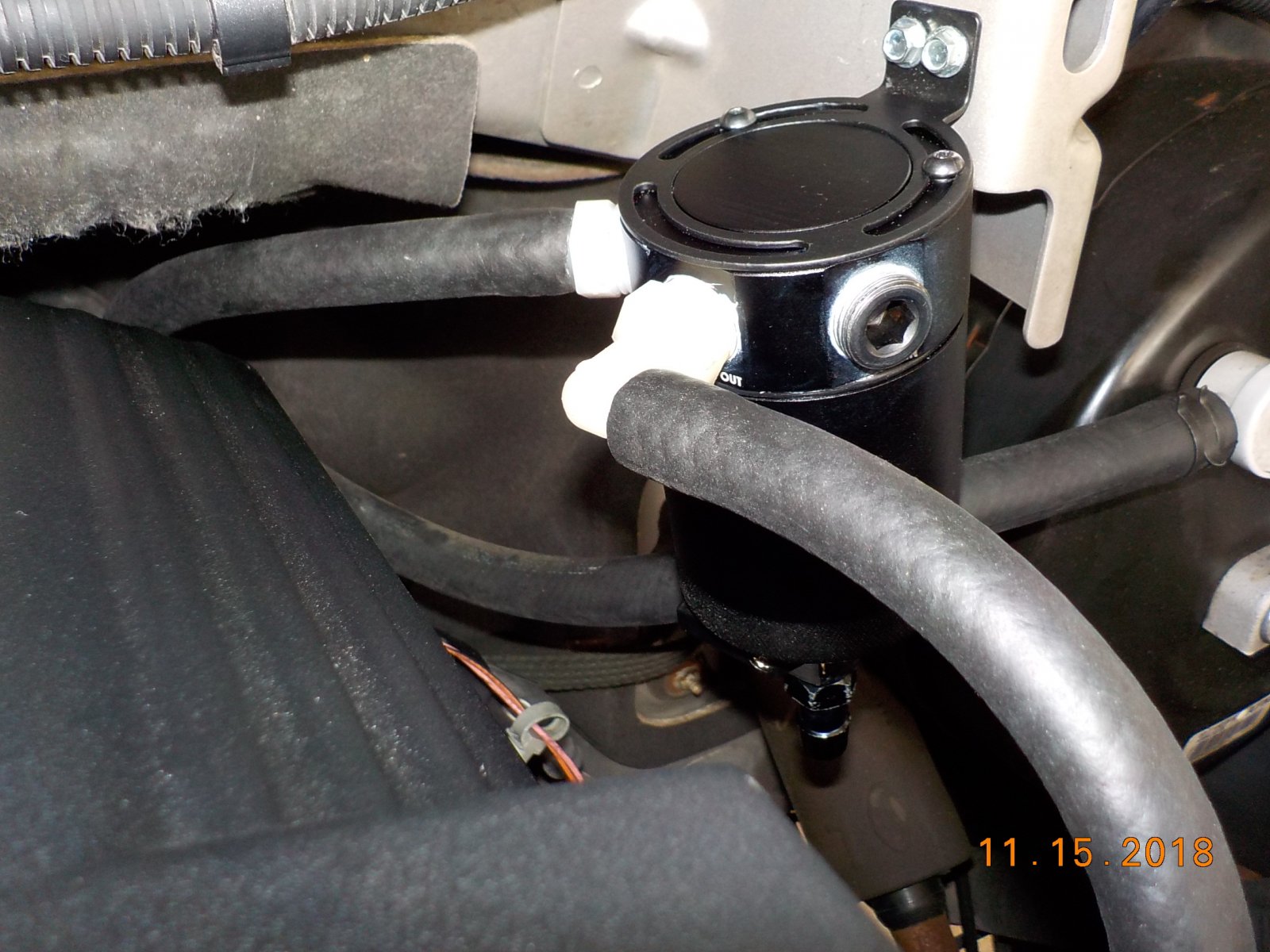

Send me an address View attachment 364937View attachment 364937
That looks like the same one I have. You'll want to drill/tap a third hole on the top for an additional mounting screw. The sheet-metal mount is kind of flimsy, and will bend easily without additional support on the top.
Since Nov. 2018, 42k miles ago, this is how mine has been mounted w/2 screws and the bottom is supported slightly by the brake booster hose.

Since Nov. 2018, 42k miles ago, this is how mine has been mounted w/2 screws and the bottom is supported slightly by the brake booster hose. View attachment 365133
I'm glad that's holding up for you, and it helps calm my tingling Spider Senses. I was not too hopeful about that circular bracket holding up over time.
