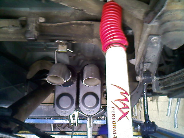

Hey mdiacont322 I have the same set up you have, and i added 2 1/4 inlet 2 1/4 out flowmaster 44s. I wanted them out to the sides also behind the rear wheel. I ended up doing this and it sucked.:emotions122: It has an ugly sound going back to to shop get done all the way to the back with chrome tips.
