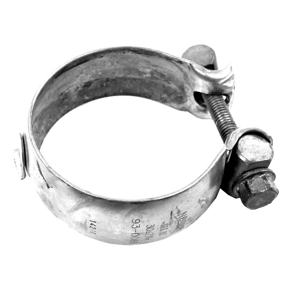

What kind of clamp do I need to put the 2 together?

I believe you weld at the joint and there is no clamp. I could be wrong, but personally I would weld it. The tiniest hole makes a big difference.
