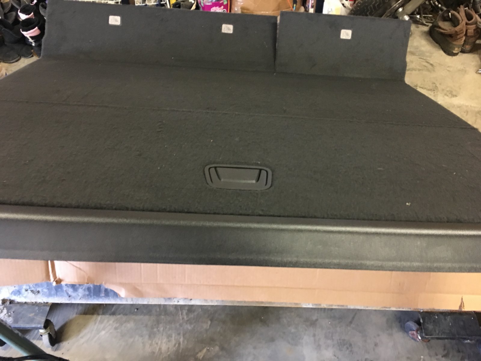

I was looking at the rear cargo area of my '15 Yukon XL Denali and thought if there was a way to remove the wedge shaped compartment below the carpeted piece it would make the whole area much flatter, at least behind the 3rd row. And that cargo compartment thing is useless, it's like 3" deep WTF am I going to put in there?
Someone needs to come up with a flat insert that replaces the divided slanted cargo compartment insert and leaves it flat, so that the carpet just lays down lower and now flat.

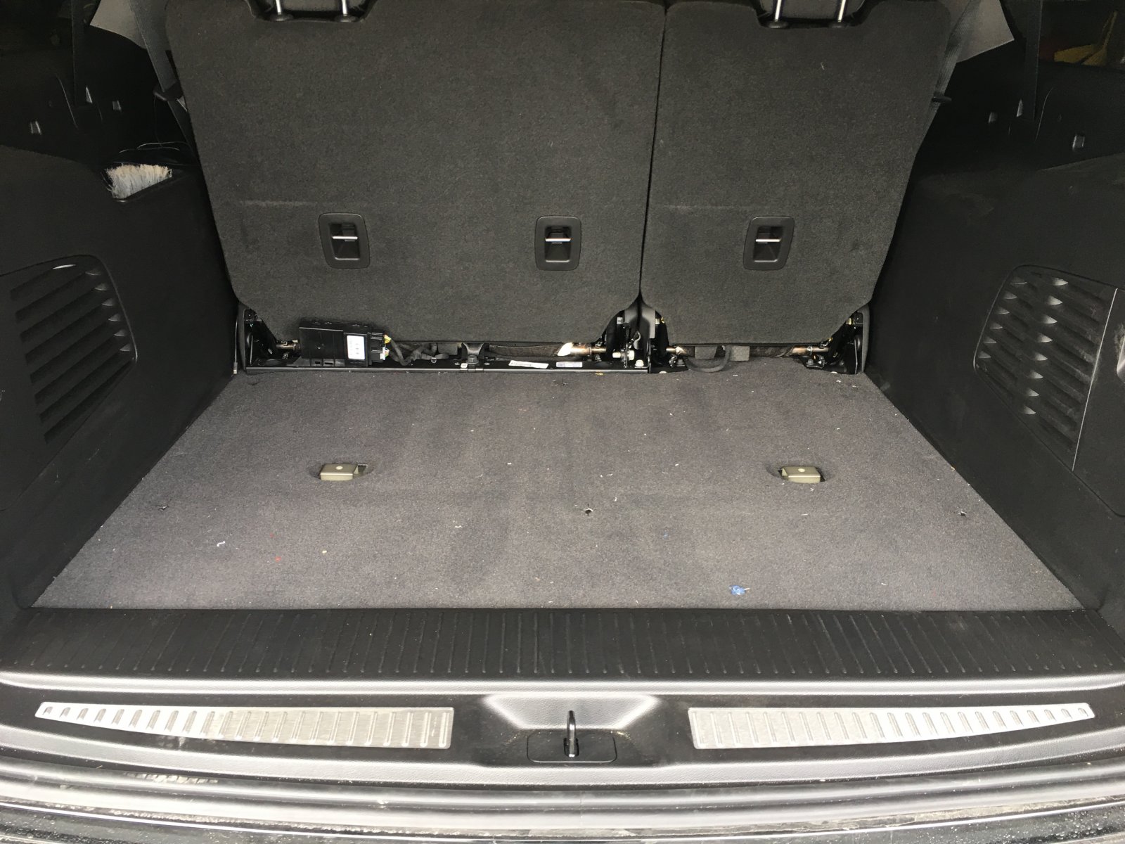

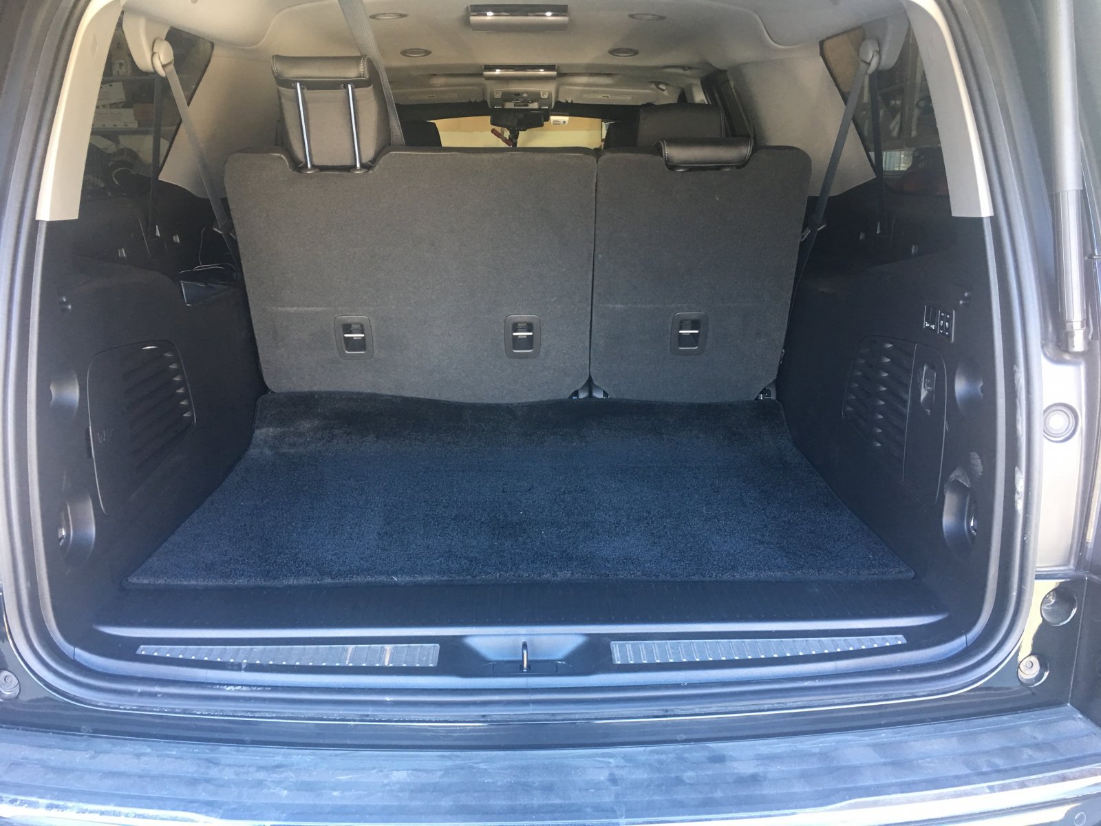

I got tired of the ‘ski slope’ so i yanked the stupid cargo tray, that doesn’t hold anything anyway, out.
My cargo mat fits perfectly, covers the holes in the carpet, runs up the back of the seat slightly covering the motors and wires and bottom of seat. I now have a FLAT cargo area, bonus is the 2-4” more height in the rear and nothing rolls to the rear, always open window first anyway.....
If i need to pick something up where i need a completely flat surface, even though its sloped, i can throw it back in or prop the rear of my cargo up by the hatch, or just use one of my trailers or the tahoe.
Stupid design imo but simple fix.

This is encouraging... I want to see what it looks like under your rear carpeted cargo mat. Got any pics of that?
Also what's involved in "yanking out" the cargo tray? Is it just some plastic clips, actual screws or what?
PG01
Nov 6, 2016
15,912
21,797
Up here to the right
Will get you a pic tonight.

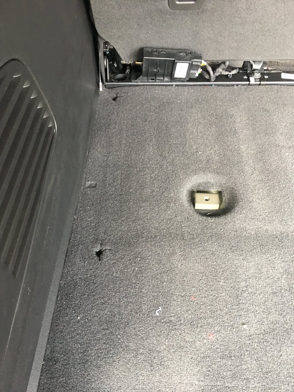

It is carpeted but there are holes in the carpet for the feet of the cargo tray.
If you open the lid of the tray, pull up the rubber mats that are in each front ‘compartment’ you will see two flat hand tigtened ‘bolts’ almost an inverted wing nut, spin them out and then lift and pull entire tray out.
If you don’t have a cargo mat however you will be able to see under and the motors and wires for the seats. Also, if you look at my pic again you also now see the ‘kid seat tethers’ molded into the back of the seat, where the tray had hindged flaps that fold and cover the tether points when seats in an up position...
ill get some more pictures tonight.
Even if I didn’t have a cargo mat, and i had to look at the wires, etc..I would still do it as the stupid slope annoys me.

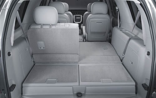

My 2006 Pontiac Montana SV6 had a similar cargo tray to make a flat floor but the skirts to cover the rear seat hardware were attached to the seat backs and not the tray. I liked having it for storing a tire plug kit, jumper cables and other odds and ends like spare wireless headsets and batteries.
