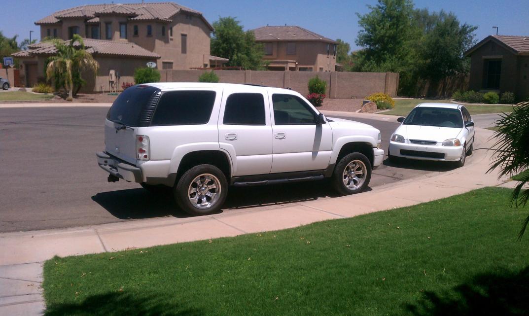

Got the job done. Not to bad... still a little to raked. Now I am on the search for a new wheel/tire setup. I did not swap the torsion bars over, so maybe I will give that a shot next weekend. I used a gear puller to get the keys in and a coil spring compressor to get the rear coils in.
All this without a broken arm (you old school TYFers know what Iam talking about)
Its a shame 295/65/20 rubber is so GD pricey!
