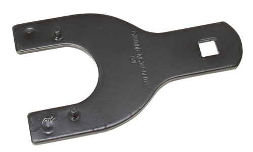

I found a tool to hold the pump pulley at the peg holes and it's a fan clutch spanner wrench. It's a Lisle 43580 and you use it with a 1/2" ratchet/breaker bar.
I got it and then rented the 36mm wrench for the nut. We'll see how it goes.

I bought something similar to this and a 36mm wrench. Begrudgingly, they were only going to be a one-time use tool to do a second water pump, but once I did that it was evident my heads were cracked. Then the refurbs cracked. It got used several times. Just got all the components for an e-fan conversion so hopefully only need the tools one more time!
