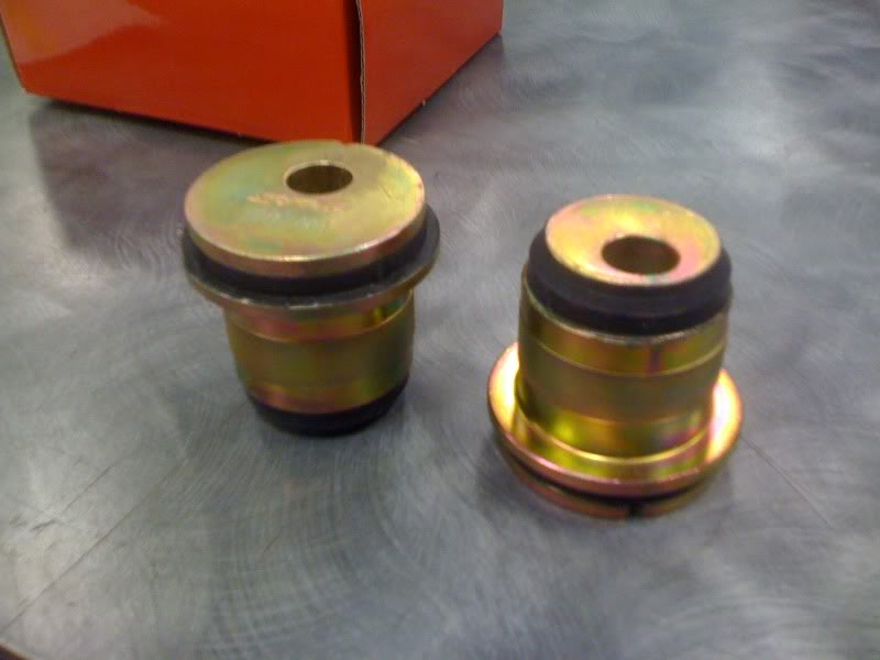

Mine has a bit of negative camber, the belltech shit is overpriced just hook a pair of the specialty alignment products 86350 they are all the same uca eccentric cam bushings
My tires don't wear enough to be of any concern but for some trucks they have crazy camber issues and eat up tires prematurely, the cams above will fix that :cheers:

They're $50/pair so $100 for both sides, pretty easy to do yourself you may have to torch the old bushings out...call around and check with alignment shops for labor on the bushings and aligning the truck after the installation.

didnt know spcs were more expensive then belltechs.
belltechs run less than 85 shipped for the front bushing kit and just did one over the weekend.
[IMGhttp://staticummitracing.com/global/images/prod/large/bel-4955_w.jpg[/IMG]
heres the instructions on the belltech install
http://docs.belltech.com/4955-888.pdf
My bad, the eibachs were the ones that were mad overpriced...$91.99/pair on summit as opposed to the spc which are $40 cheaper/pair. Looks like the belltechs are the less expensive for some reason I thought they came as a pair of two not the entire set, $85 shipped is mad cheap :cheers:

alignment bushings from belltech is all you need.
