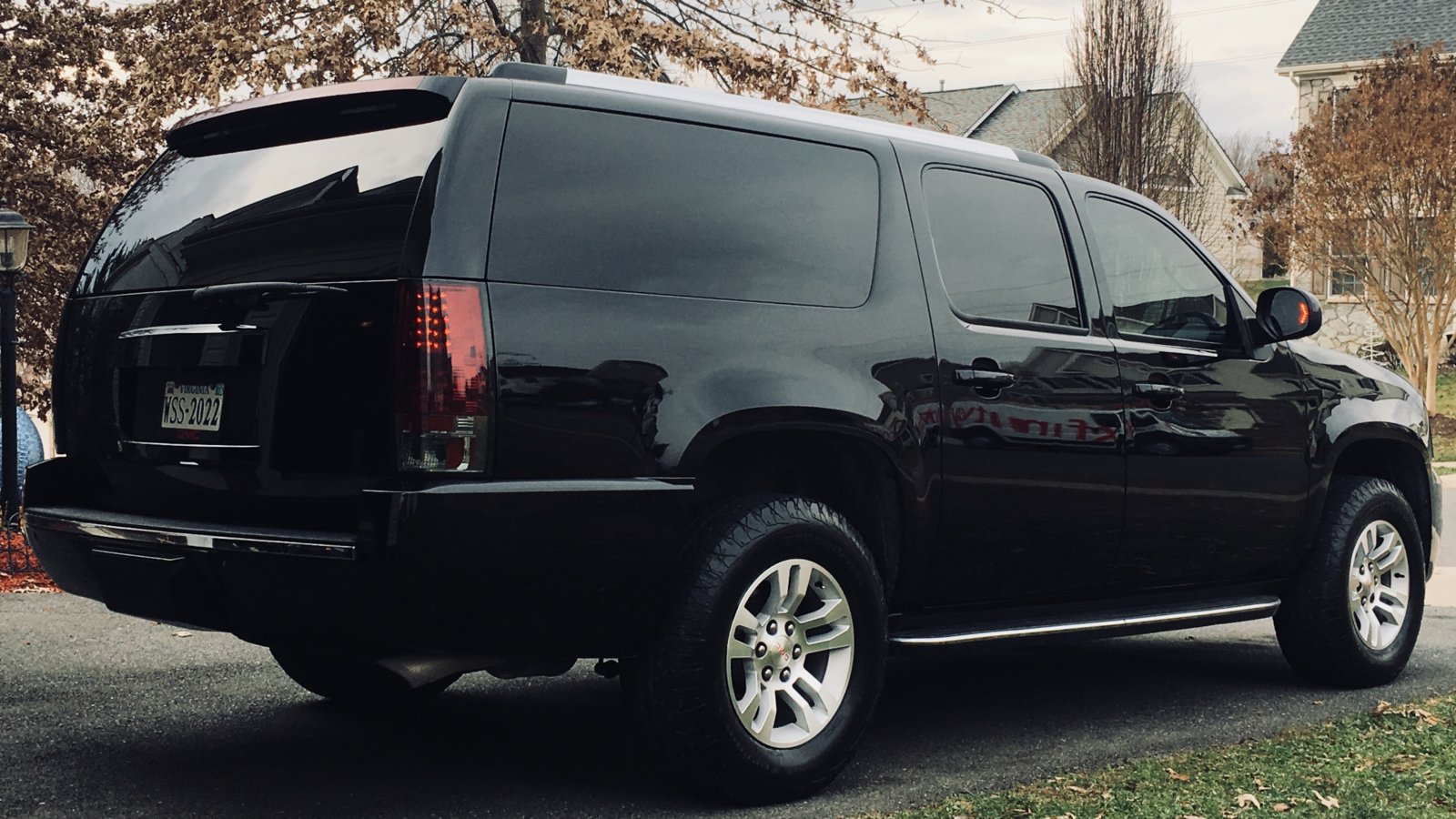

was supposed to level but it looks like it has a slight squat now in the rear? 07 yukon denali xl
is there anyway to even it out ? any rear level kit for this model denali or workaround etc ? it does have the air ride currently? squat does not look as bad in pic because drive way has a downward grade.

was supposed to level but it looks like it has a slight squat now in the rear? 07 yukon denali xlView attachment 192407 is there anyway to even it out ? any rear level kit for this model denali or workaround etc ? it does have the air ride currently? squat does not look as bad in pic because drive way has a downward grade.
Plenty of options. Suspension max has a kit. What’s the fender heights front and rear?

Checked out Suspension Maxx, did not clearly say wether rear coil spacer would work with the air ride and could not find a 800# tech support? not 100% sure on fender height would have to go out and measure....but before front level had stock rake now on level ground rear sits lower then front pretty clearly.

You need flat level ground to measure the fender heights. Once you have measurements then order the rear spacer from whoever but suspension maxx does offer a bracket to adjust the ride height sensor. Just call them 1-888-629-9226
