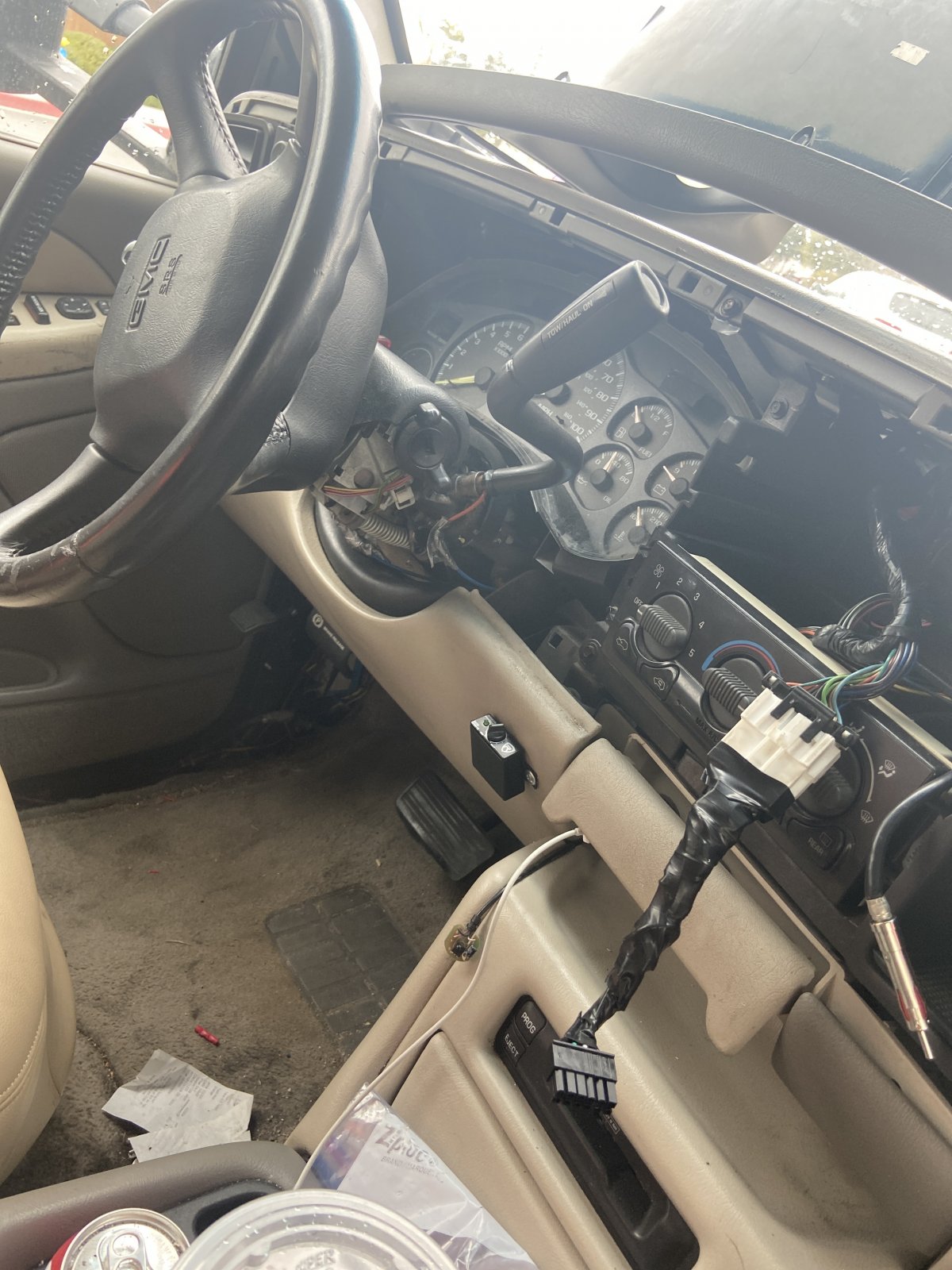

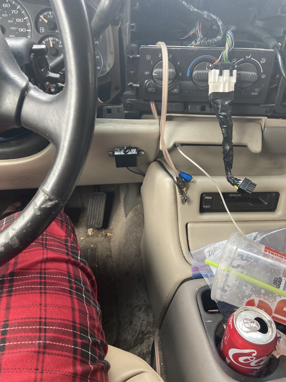

I screwed my bass knob into place I’m gonna sneak the cables into my trim minus power and ground due to it raining outside

I don’t know how Metra managed to give me the wrong connector in the correct bag

It’s the exact same connector so I’m just gonna shove the wires into the factory connector

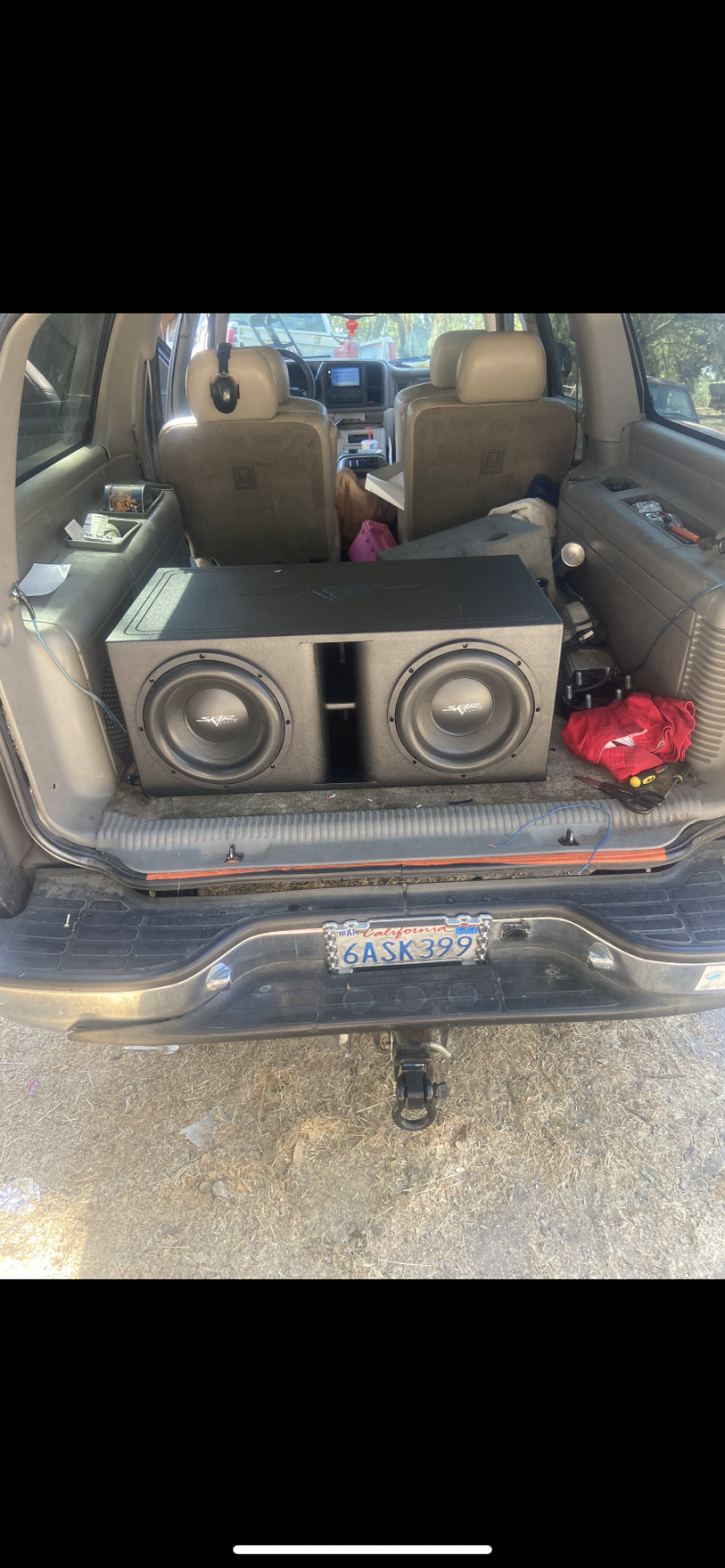

I actually have a way better system now besides a aftermarket door speaker /tweeter amplifier but I basically cut the wires at the ends and followed a wiring diagram I think I’m gonna clean out my truck and take some pictures of the exact wires that need to be put together in a 2001 gmc Yukon xL no Bose with subwoofer I bought the metra harness that was supposed to work and I got scammed on eBay so I hillbillied the wires together I’m considering making a wiring diagram for future entries as mine is already done on headunit power and sub amp with 2 12’s skar super tweeters and skar tx65’s

Assuming it’s a 2001 tahoe /suburban etc I would highly recommend the box I have with different subs (they have a unique smell when going hard that doesn’t go away unlike other subs I’ve seen friends use) and go for the big boy skar amp 1200+ w rms and 1/0 wiring like I did if you invest in the big boy amp like bigger than mine you can rattle your headliner to your hearts content with a nice battery and big 3 upgrade (I have yet to do my big 3 but I have other projects like my camo headliner).

I actually have a way better system now besides a aftermarket door speaker /tweeter amplifier but I basically cut the wires at the ends and followed a wiring diagram I think I’m gonna clean out my truck and take some pictures of the exact wires that need to be put together in a 2001 gmc Yukon xL no Bose with subwoofer I bought the metra harness that was supposed to work and I got scammed on eBay so I hillbillied the wires together I’m considering making a wiring diagram for future entries as mine is already done on headunit power and sub amp with 2 12’s skar super tweeters and skar tx65’s View attachment 409239
