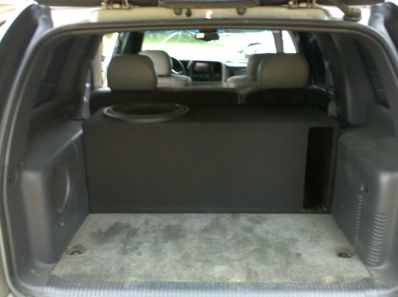

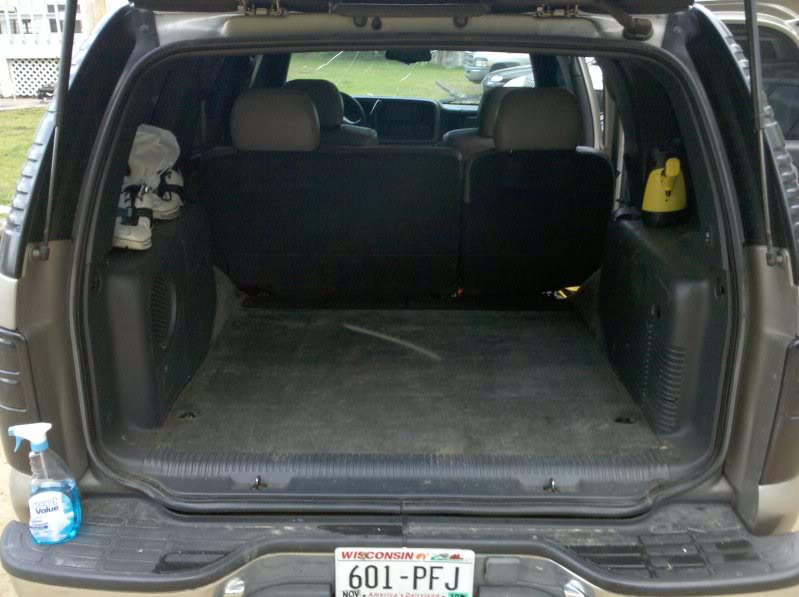

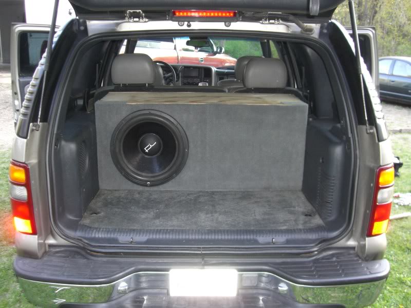

Finally got a new box built..the old one was way to big and didnt sound very good anymore..
new box is 8 cubes after sub displacement, 32 hz..it hits so hard..the sunroof slaps around where it didnt even more before..I have a pounding headache from about 10 seconds and that hasnt happened before lol..pretty pumped..

should have done the port on the drivers side but still better than before with sub up and port back
I love the old triple stack BTL's :)

i just noticed that they are making them one magnet now..just a design change or what?

they have for about 2 years now, its a huge magnet
handles the same if not more
sounds good too

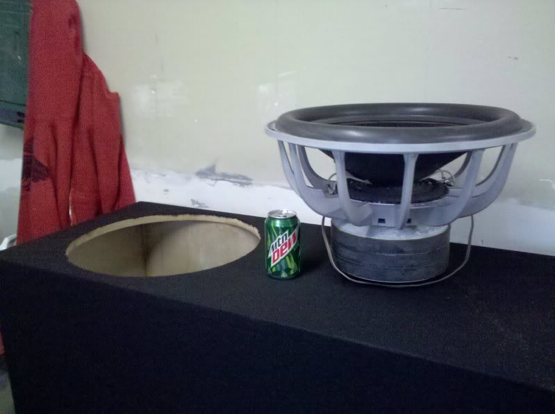

the box is 49x19x19. the port is 17.5 tall x 5 wide x 21 deep. 8 cubes, 32 hz
i used this calculator
http://www.the12volt.com/caraudio/boxcalcs.asp
I wouldnt run 10 cubes unless your subs are 5 cubes min..thats a lot of space..my old box was 12 cubes and it sounded like shit compared to this one..

the port came out the side of the box above the wheel well..
