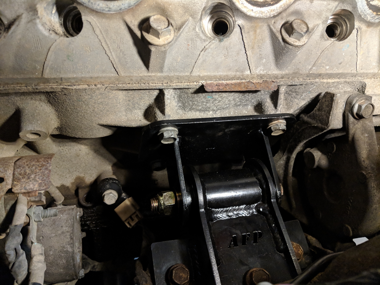

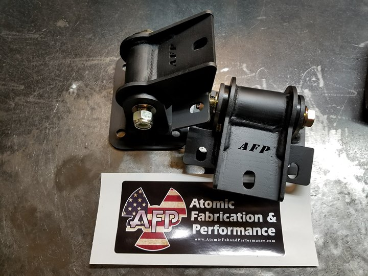

Question regarding SOLID motor mounts....there is a screw in the middle connecting the 2 pieces (1 side to engine, 1 side to body). How much tq needed to tighten that bolt?
randeez
Sep 29, 2017
8,140
25,761
south florida
im guessing you mean the atomic poly mounts?
i wouldnt try and mount each to engine and frame and then line up and put the bolt thru the middle.
make the mount up out of the truck, put the bolt thru the middle. it's a 1/2" bolt iirc put 65ft lbs or so on it - you could prob put 100 on the thing and its still going to hinge. bolt it to the engine first and swing it down and bolt it to the frame with the three stock bolts.

I slapped mine in with the bolt already through the middle. It's hinged so just fold a bit and bolt in tight enough.
