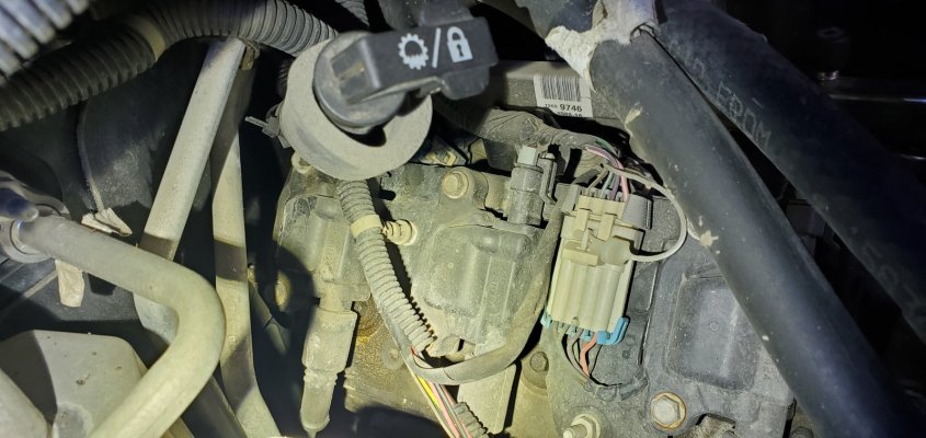

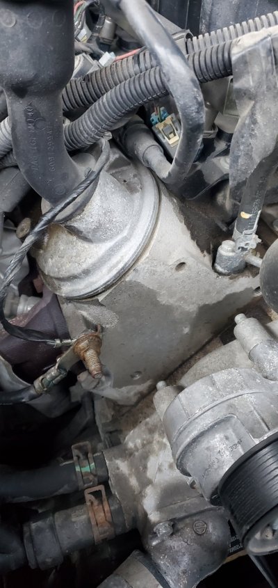

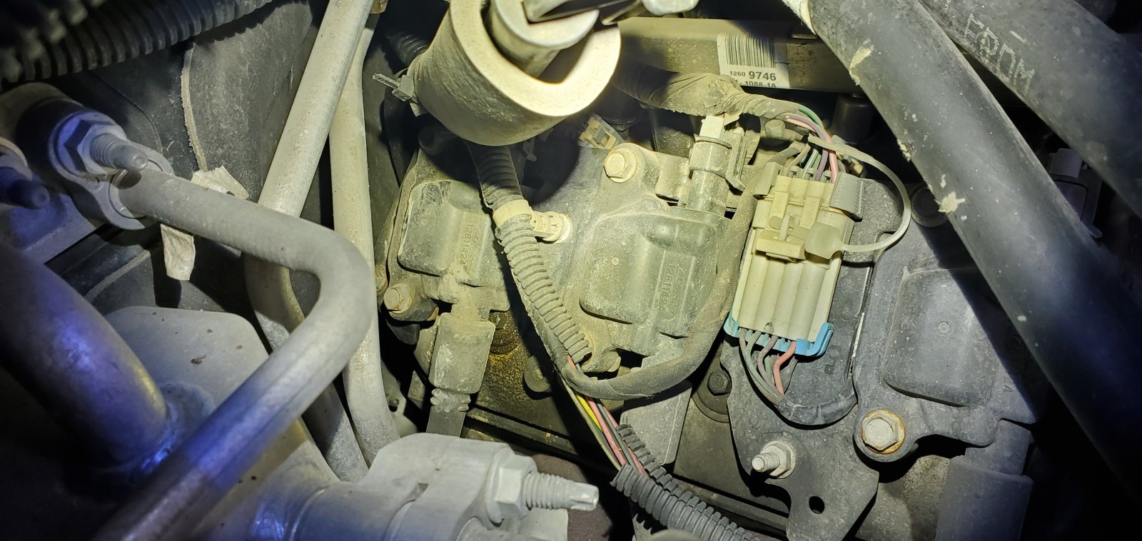

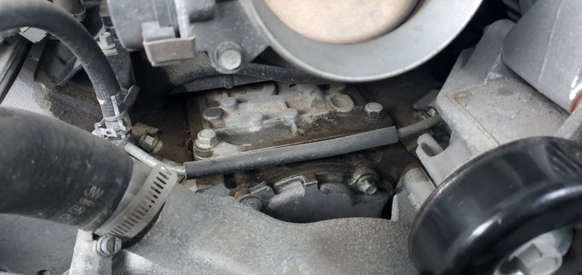

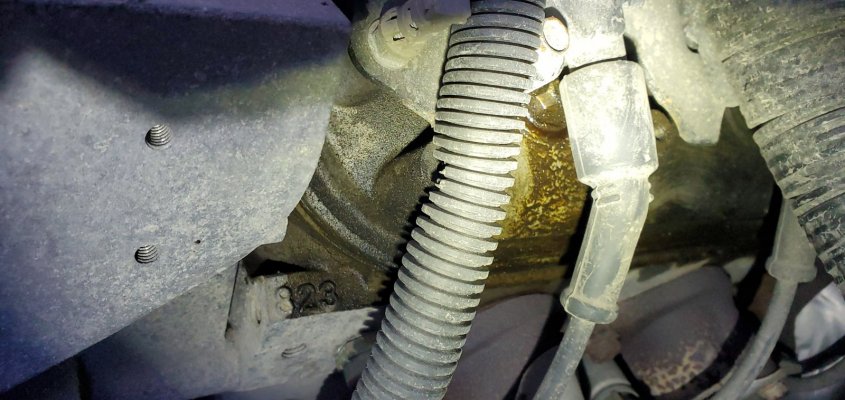

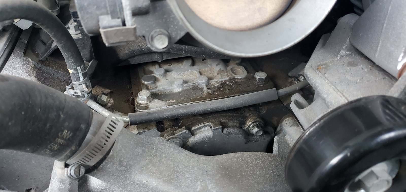

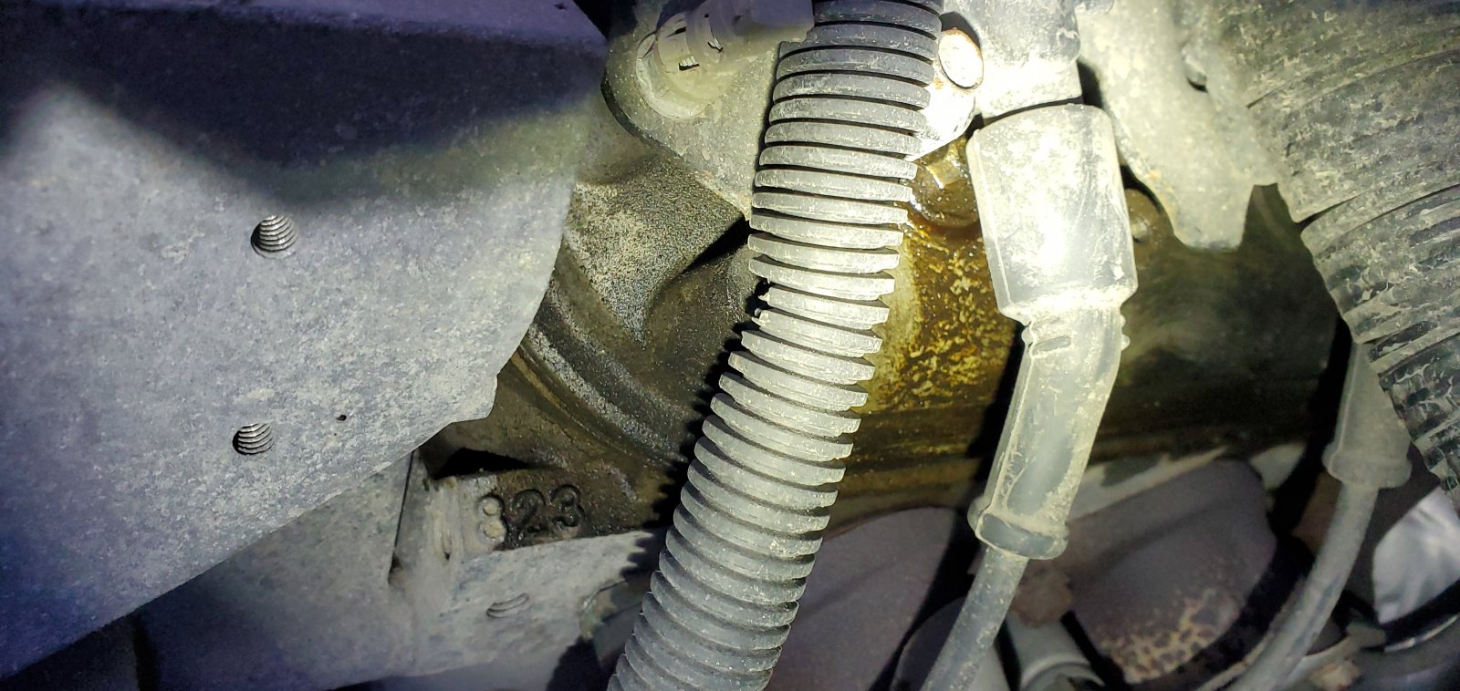

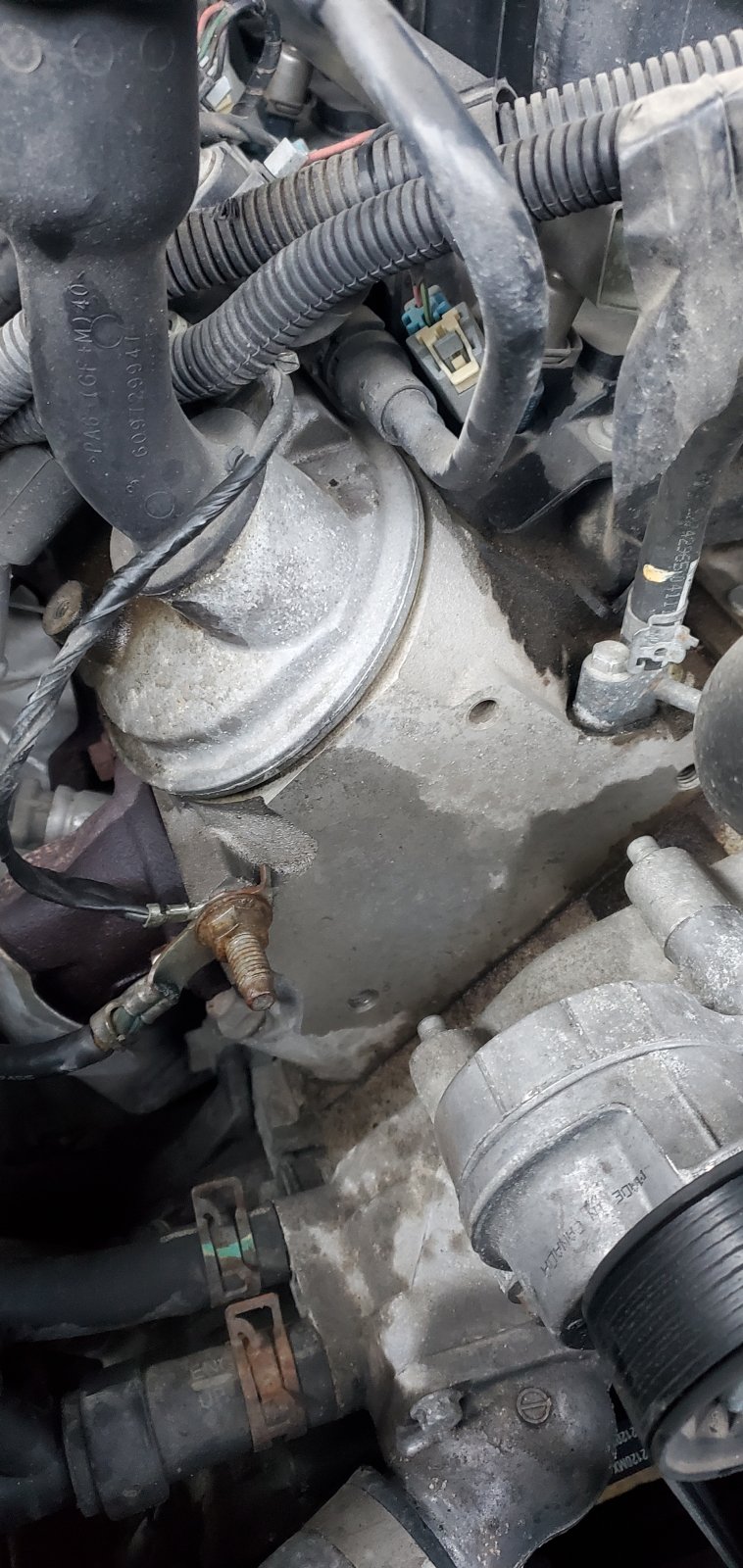

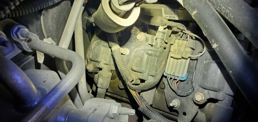

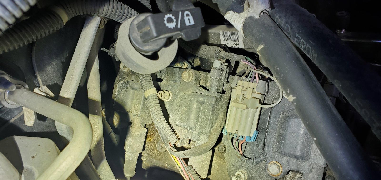

I have the lovely broken rear exhaust manifold bolts to fix. I have the brackets that I could do a temp fix with, but thinking that I want to do it the right way and remove the heads to get the broken ones out. Partly due to seeing oil around the valve covers and I am not sure where it is coming from. I have read that there are issues in the valley cover area and wondering if it is there, valve cover gaskets or something else. My plan would be to remove the heads, get the bolts out, have a shop check the head for level, new gaskets on everything removed, etc.
I am thinking to do all of this at once since I will be in there, so I am wondering what else I should look at/consider doing while I have it tore down this far. I've done the oil pressure unit fairly recently. I've read that there are some issues with lifters in some of these, but not sure this is that year. It's a 2011 Yukon with around 170k. Attached are a few pics of the oil that I am seeing. I live in a cold climate so it will still be a short bit before I tear into this. Thanks for any suggestions.

Definitely do the valve covers and the VLOM cover. Looks like both are leaking.
IF you pull the heads *which I wouldn't think you have to* for the exhaust threads....
I'd do the lifters.. You'll need 8 regular and 8 AFM lifters.. Then program the AFM/DOD OFF !
If you already have the DOD/AFM turned off in the PCM, I wouldn't worry about the lifters as
long as you know they are working correctly now

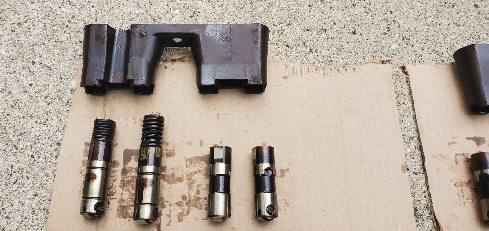

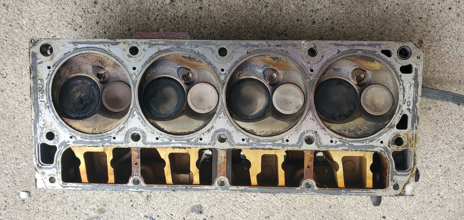

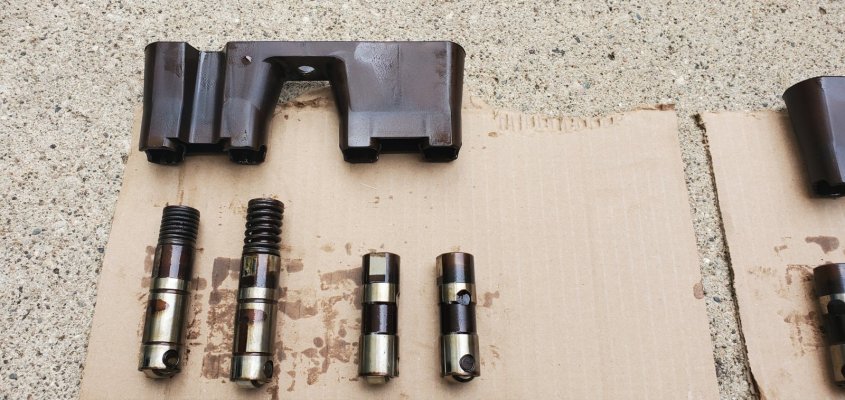

Well, I just got a misfire code on cylinder 1. No better time than to tear down. The rocker on cylinder 1 was loose (not sure how to attach video clip). Got to the lifters and found that the loose rocker appears to have a lifter with a collapsed (stuck) spring (see photo). Is this the issue that is mentioned frequently for failing on these AFM systems? The rods appear to be straight still. Anything else to look for? It only ran a short time after the misfire.

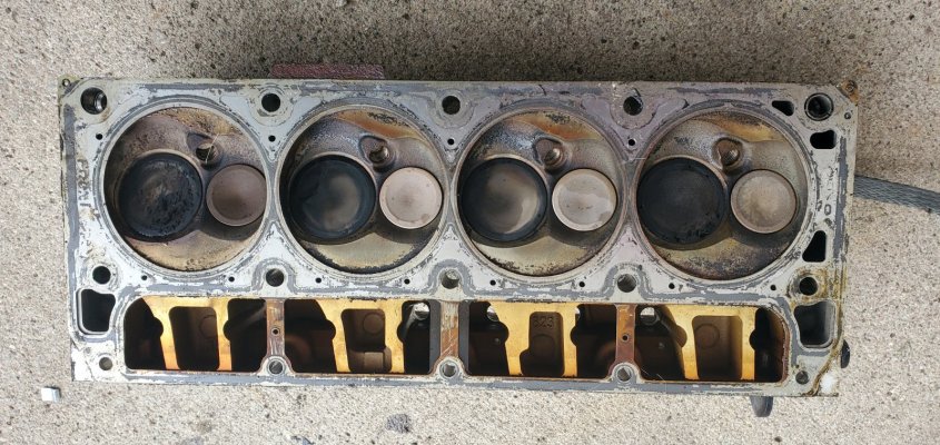

So the heads are now off and going to the shop for a check and clean up. I was reading in other posts where some do a 3 angle valve job. Should I consider any such thing for the shop to do or consider new springs and clips? If I do any of these things, will it throw off the push rod length...not real interested in getting that detailed, but will if needed.
