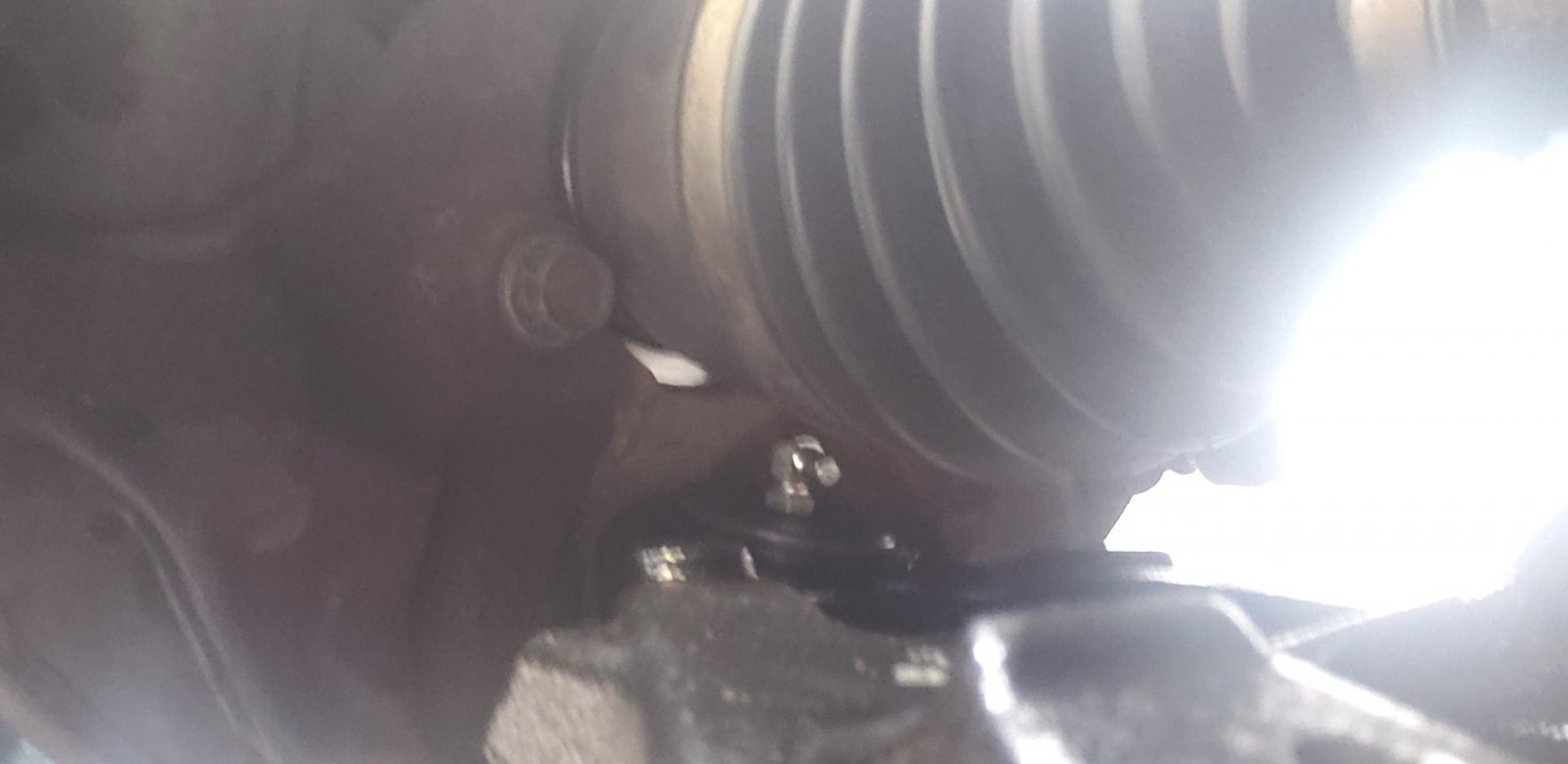

Just installed my new Moog lower control arms. I didn't realize the grease fitting came broken on the driver's side.
Can I just screw another fitting in? I was worried some shavings would get in the grease (not sure that even matters)
I can easily pull the axle out again and get a fitting in there. I am kind of a time pinch, do they have any fittings locally anywhere?
Amazon is a week out from another control arm and I don't see this good CK version anywhere locally.

My arms came with the fittings sealed in separate bags so they could'nt get broken off in shipping or installation. Odd that yours were already installed. You can screw another fitting in there, but if the original one was broken off, it's threads may still be in the ball joint cap. You should be able to tell by wiping it clean and inspecting it with a bright light. If they're in it and it's broken flush, You can use an Easy Out extractor if they make them that small. Or, you may be able to stick a small flat head screwdriver in there and wedge it just enough to grip and remove the piece. Most flat head screwdrivers taper out as they leave the tip so you'd want one that does this and has sharp, square edges to help it grip. You don't wanna wedge it too tight and expand the piece tighter against the threads in the BJ cap.
New fittings are available everywhere- Most any decent hardware store should have them, Lowe's, Home Depot, any of the auto parts stores, Tractor Supply or other farm supply store, etc. You may wanna remove the other one to reference the style and thread size.

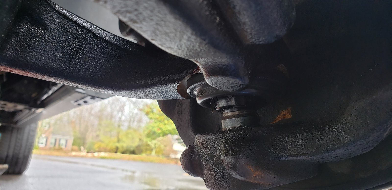

I was able to get the broken grease fitting out.
Got a new one on there.
I go to put in the grease, and the grease started flying out the bottom. When I did the others, you could see the boot swelling and then eventually some would ooze out.
I am thinking the damn boot is torn and I am going to have to replace the arm anyway. So annoying!
I hope I am wrong. I think I am just gonna roll with it and see what happens. Maybe the boot just got put "into place" from the driving and this is how it's really supposed to work.

You can get replacement boots for them instead of the whole arm or another ball joint.
When you replaced the grease fitting did you just push the axle back for room or did you separate the spindle/knuckle from the arm? If you did separate, you could have damaged that boot, like you think it is.

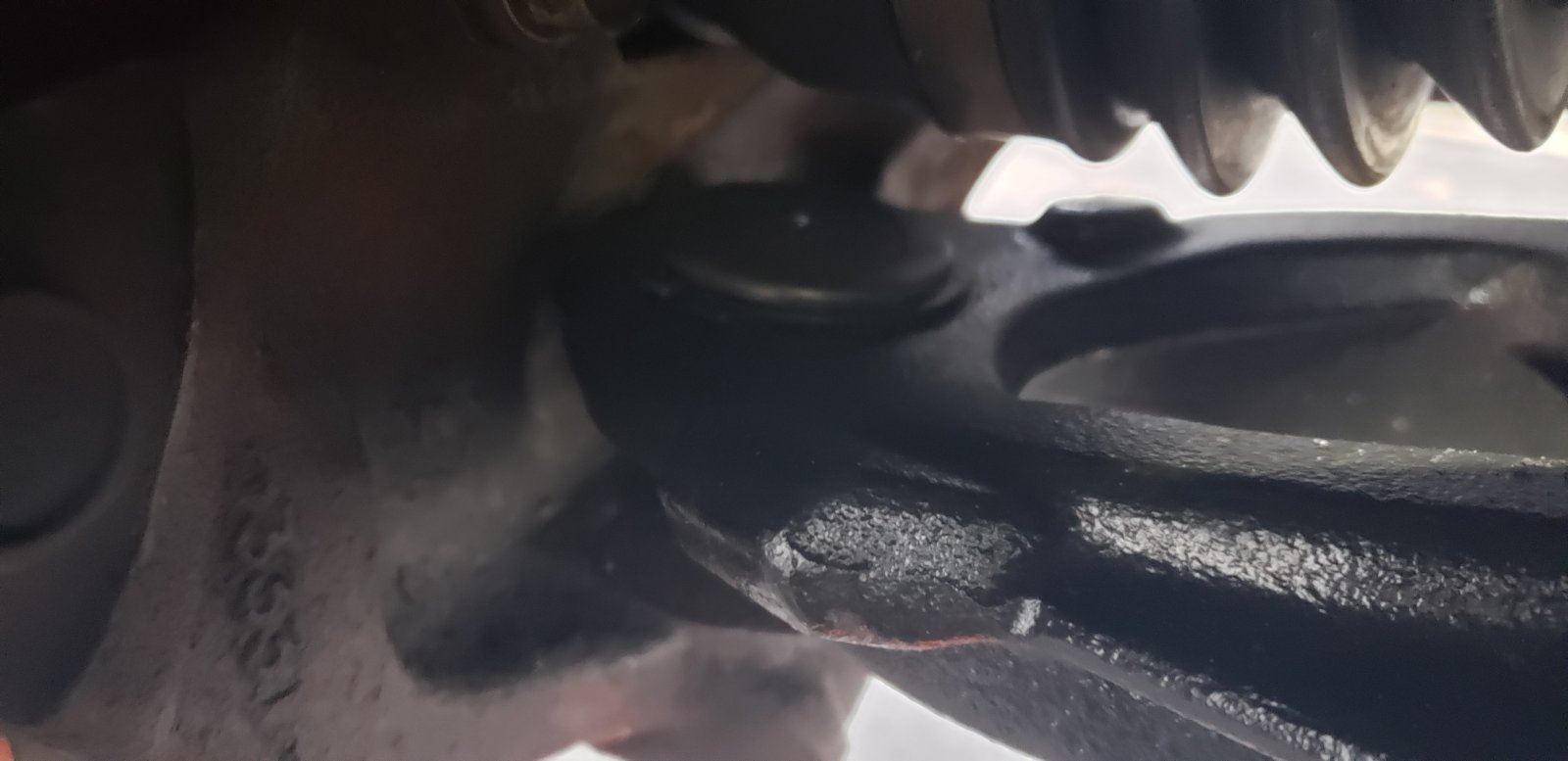

I pulled the axle and strut off, did not remove anything on the knuckle. I'll try to snap a pic

Maybe the boot popped off the ball joint???
Good call. The boot should have a rubber covered metal ring inside there at the lip and you have to push it down, all around, to seat it properly. If you find it that way you will want to be sure that where you push it back down and seat it on the ball joint, that surface lip of joint should be dry and the inner edge of the boot as well, so they GRIP each other. If is greasy then it will slip off again.

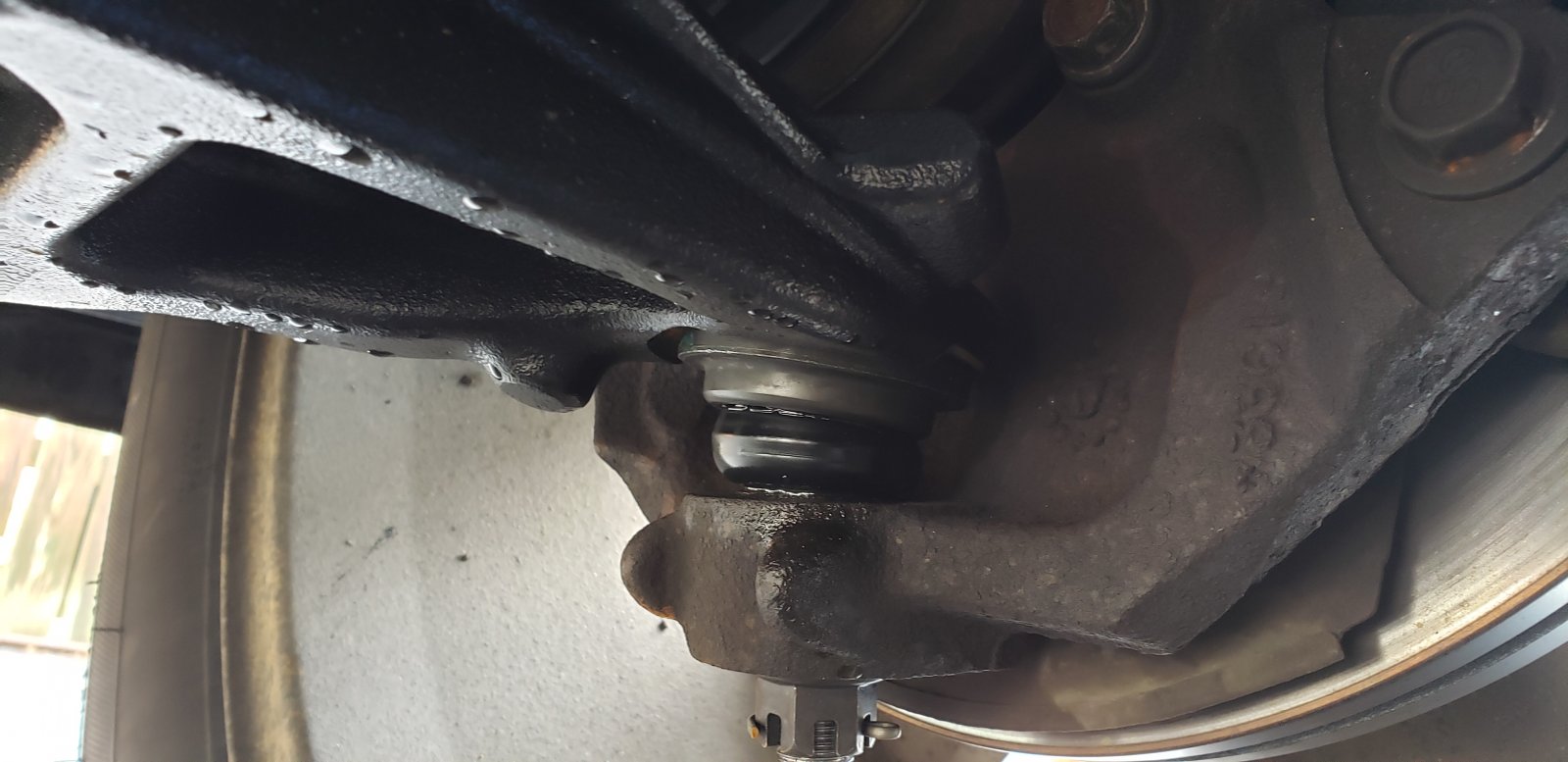

I think it's correct, the other side just didn't ooze the grease out yet. You can see on the right side, there won't be much room for grease.

I just got carried way on the passenger side, hopefully that tension releases soon. Either that, or the passenger side is a different design.
