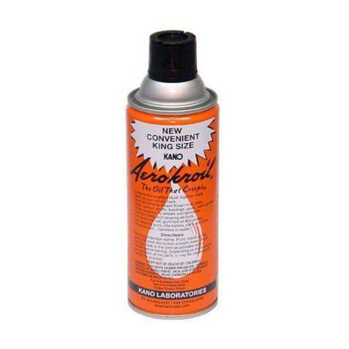

I'd drill them out and replace them with a bolt, lock washer, and nut.
I just did a bunch of exhaust work and soaked everything with this stuff I call it creep oil. We use it on aircraft and it's by far the best penetrating lube I have found for getting stuck stuff unstuck. Obviously too late for that now but that's my suggestion for next time.
