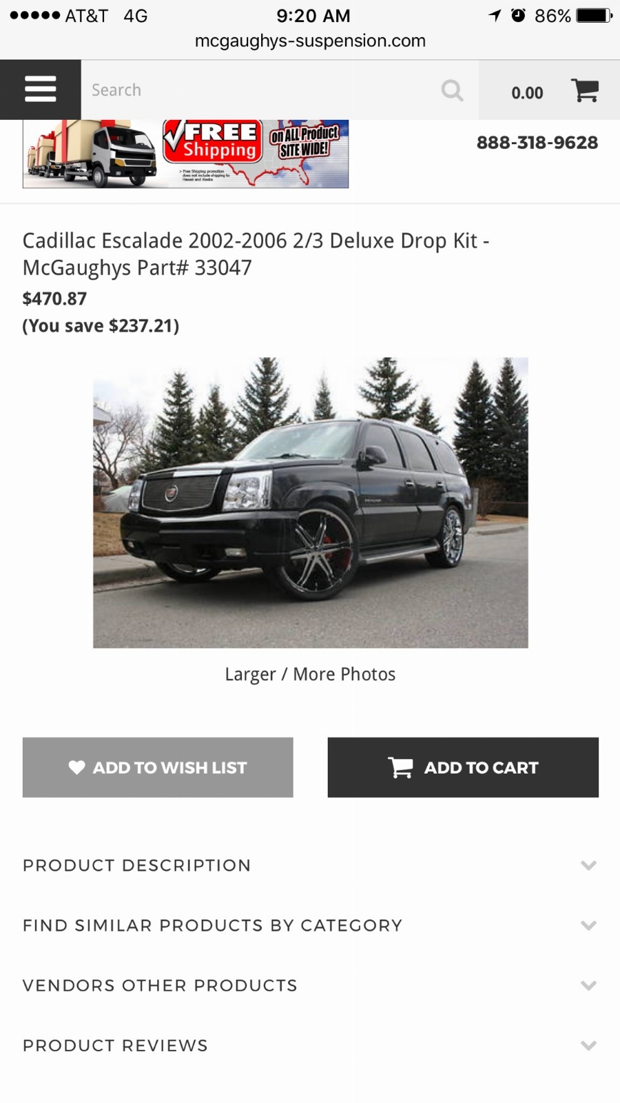

Looking great! Are you going to do any suspension upgrades?
Im thinking about going with a 2/3 drop and keeping the Autoride, gonna hit up Tony and see what kinda kit he can get me

2/3 drop will look good. Looking at a little more $$ to keep autoride with a drop kit but your ride not mines. I personally think the system is outdated and too spendy to keep and maintain. Install helper bags and call it good.

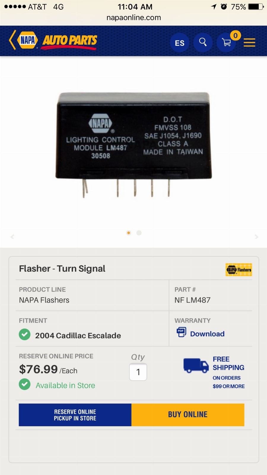

Thanks, I'm definitely going to do LED's just didn't feel like taking the dash apart to replace the flasher, not a fan of resistors, if the shocks, compressor and ride height sensors weren't all new id look at ditching it, it was all replaced before I got it

Yup so much easier just go to Napa and they have the LED flasher in a day swapped it out on my OBS

I remember doing that with my 89 back when leds first came out. But I've checked recently and they didn't carry flashers for newer vehicles.

Na they stock them or atleast they do here, there's one for the flashers and one for the hazards
Had no idea that was an option! Where is the how to?

It looks like there is one for the flasher and hazards replaced them on my OBS and the LED's worked perfect there are a few vids online you take that lower dash panel off under the wheel and ones there not sure on the other but if it's like the OBS you need to do both or they won't work

Ya it's way better then resistors screw that nonsense, I'll only be running 4 bulbs off it since my rear tails are LED with a built in resistor
