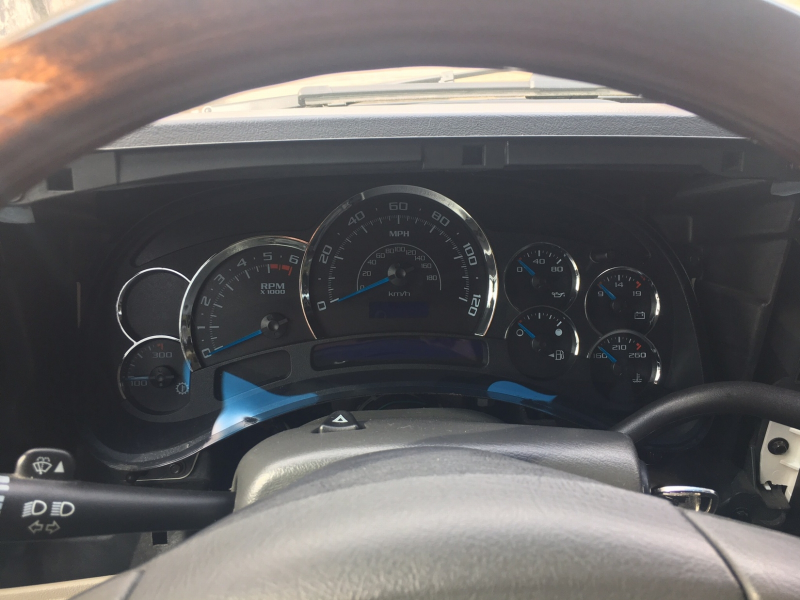

Why not just buy the Esky face? I've seen them om eBay. But I'm not too sure if your Denali clear bezel's cutouts for the gauges will fit. If not, they sell those too.
Or that you can get them from where I got my cluster for $58, they have the needles and everything else to convert it to the Platinum cluster, being as they are located in CT ordered it yesterday and got it this afternoon I just didn’t want to be without the truck for that long
Yeah but I don’t have an esky cluster to begin Lol

Now you got me looking at them on eBay! Haha. How hard is it to swap a cluster?
lol it’s pretty easy pull the dash bezel, remove four screws and undo the connector, just have to have it programmed to your vin so it works correctly and they can set the miles & hrs for you
As far as I know, you don't need to program your vin in, should be pnp. Only thing you need to do is program your correct mileage in. That's even if you want to do that.

Dammit you’re getting me in trouble! Lol I did exactly what you said and I’m gonna put one together! Everything’s ordered! Lol! How hard is it to swap the face and needles?!

If it’s a cluster that hasn’t been installed in whatever truck it’s going into, you need to have it programmed to your vin if not your gonna get brake error messages, steering wheel button issues, etc. the place I got mine from did that and the miles/hrs for free
I’d PM ScottyBoy he should be able to help you

i just shot him a message to ask about converting all the lights to LEDs so I don’t have to worry about any burning out. I’m gonna just have it all programmed. Would I have to do that at a dealership?!

Not sure on that one maybe someone can chime in
Really? I've never hear that before. Interesting......

Here’s a pic during the day that shows the cluster better
