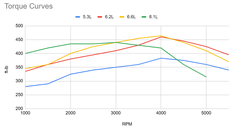

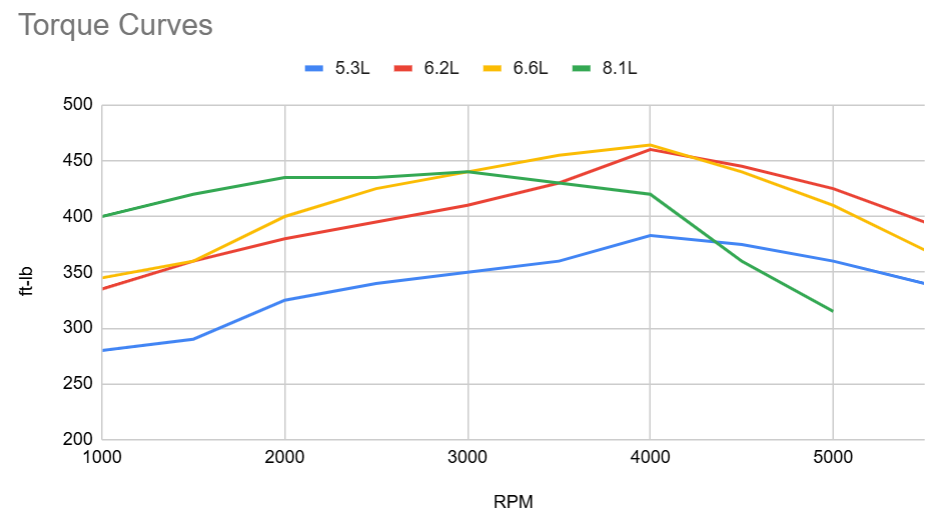

It also makes less hp. So you think that the reason for this is afm/dfm? Lol
Horsepower doesn't mean a lot for Trucks, and Torque is what you feel when you mash the throttle and are pushed back
Horsepower = Torque * RPM / 5252, so if an engine makes torque closer to 5252 RPM it is going to make the most horsepower.
6.6L's intake/cam design is optimized to make torque in the lower RPM, and by 'virtue' of the horsepower math mentioned above it makes less horsepower than the 6.2L.
See the curves below, 6.2L makes more torque than the 6.6L over 4200 RPM, and thus the peak horsepower is higher by 20 or so...... BUT..... the higher torque of the 6.6L in the 1000-4000RPM means increased leverage to move tires in the lower RPMs (necessitating smaller throttle application = reduced fuel consumption) where the vehicle is driven mostly.
Along those lines we've already proven here in discussion that the 6.2L is actually more fuel efficienct than the 5.3L.
More throttle = less mpg.
When comparing closely related engines in terms of appetites/application
Bigger load / vehicle weight = more throttle. Bigger torque = less throttle.
We are dealing with vehicles that are REALLY HEAVY here, and they seriously need some good low-end torque to improve fuel economy.
You have a diesel from what I can tell, so be happy and move on, lol haha

Be happy with what ? This thread is heavy with misinformation

That you don't own a 6.2L, and the fuel economy on the diesel
Yeah no doubt. But its the misinformation. This thread is full of it.
I think rather than objective data people just are going by 'feels' lmao
