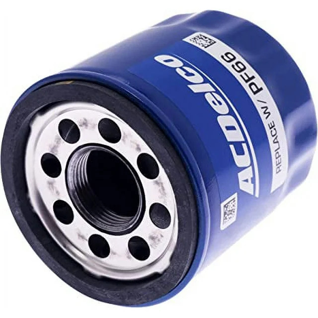

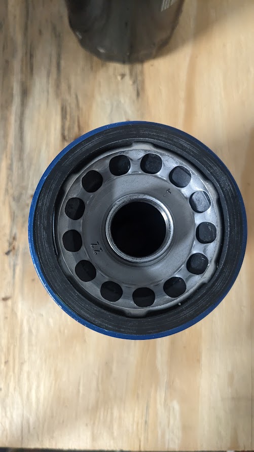

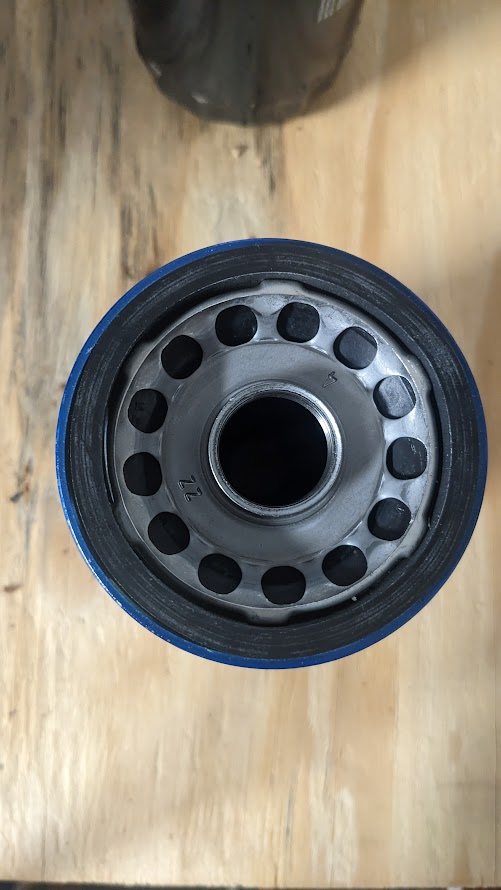

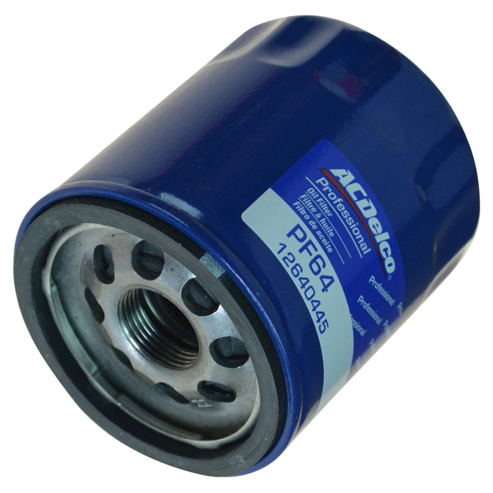

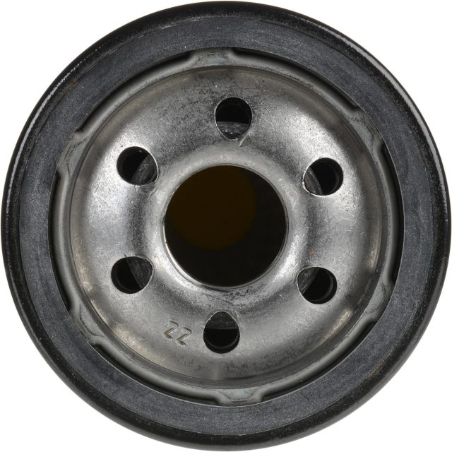

You also clearly missed the issue on the oil filters.
You keep referencing the oil filter for you DuraYuk, which is different than the 6.2l.
But just to put it out here 1 more time, PLEASE PAY ATTENTION.
Notice how all the standard AC Delco OE filters have base plates with larger and more oil inlet holes. I do not care to research the 3.0l Diesel oil pump and filter, not my problem, do not own one and will not own one, but the way GM implemented the variable displacement oil pump on the 6.2l with its internal pressure control spring is not very well thought out IMHO based on how the 6.2l engine is loaded when driving.
You clearly have not done the logging and data gathering I have done on a 6.2l much less you probably have not even driven a L87 vehicle on a longer trip to see the the Transmission Control Module loads the engine up. And just think about what happens when you fill up one of these Suburban/Yukon XL/Escalde ESV, with 4+ people and gear then add the wind resistance and additional weight of a trailer. Your going to tell me with a straight face 0W20 is more than adequate and will allow these engines to last 300,000 miles??? Also understand that if any of these 0W20 engines end up with 150,000 miles or more, a smart person would switch to 5W30 or 0W40 to offset engine wear as well.
Just because "everyone" is running 0W20 or even lower viscosity oil (0W16 or 0W8) is it a wise idea? I plan on keeping my engine running for at least 200,000 miles, if not more. I would expect more out of it if was not for the DFM trash. You claim is it just technology, it is junk, too many moving and operating parts that are not necessary. The ONLY reason for all the stupid cylinder deactivation is for EPA/CAFE requirements. Over complicate something that is reliable and it becomes unreliable and expense to maintain and repair. I did not buy this vehicle for fuel economy, I bought to haul people and gear and I do not need a bunch of crappy DFM parts failing in under 100-150k miles that cost me a bunch of time and money.
The problem is these days all are options are limited and we all try to take the best of the worst.
PF63 base plate
PF64 base plate
AC Delco PF66 base plate
Typical AC Delco Gold base plate UPD63/64/66R type
The 6.2 has a upf filter equivalent. I just used tne Amazon link to show the picture.

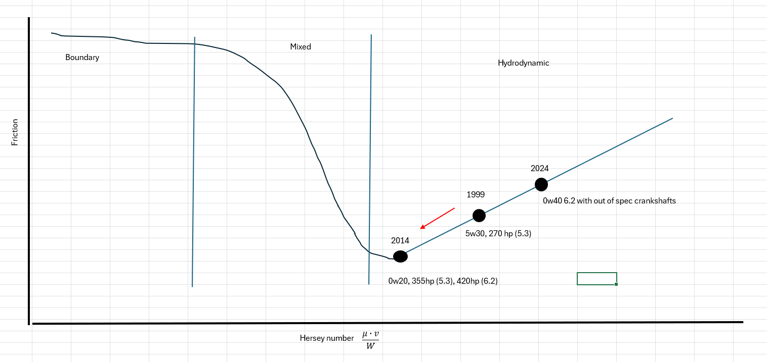

GM adds more power and reduces viscosity which puts the bearings and rotor closer and closer to a mixed lube scenario vs original design.
The dimensions of the crank and rods are not changed since 1999. This isn't a fresh bearing design that was originally designed for 0w20.
All this does is reduce safety margin and by default adds risk to the customer.
But somehow...in 2024 when out of spec cranks were found the solution was to change oil spec to 0w40.
If 0w20 had no role whatsoever in this failure, then there would be no mention, not a peep, about 0w40 or any viscosity change.
I'd rather run an oil that can mitigate or neutralize some imperfections in machining than an oil that has to have the surface and dimensions absolutely pristine.

Take a look at these 2 pictures of GM oil filters, one is the OE PF63 and the other is the UPF63R Delco Gold filter. Understand that there is a REASON that GM has so many larger oil intake holes in the PF63 oil filter. I do not know the full reasoning behind this, but part of my thought is to allow better oil pressure charging with the Auto Stop/Start nonsense and overall less restriction on the filter inlet. Additionally the PF63 probably flows better than the UPF63R based on the oil filter media. Regardless of how great/fine the oil filter is, the oil keeps dirt in suspension and the primary way to get dirt, soot and other small particles out of the oil is to change it! Changing oil often is far cheaper and easier than an internal engine repair.
If you are so worried about oil filtration, install a bypass oil filter and use the PF63, you would be far better off than screwing up the variable displacement oil pump performance and operation.

"Support" is not the correct wording. "Prolong" is .. there... I fixed it for you.....
Watch this and tell me this guy doesn't make sense.....
No 'support' is the right word. As in reaction forces developed in an eccentric rotor and hydrodynamic bearing system.
Video essentially says go up in viscosity if you need to.
L and C haven't changed since the LS days. But viscosity has dropped yet power goes up.
What provides the support, the reaction force, for this? The oil film.

This is not true, the engines are constantly changing, and the crankshaft is different, and even the connecting rod liners are different
different part numbers but dimensions aren't.
LS1 crank journal specs: https://www.onallcylinders.com/2017...ormance-bore-stroke-cylinder-heads-cam-specs/
L87/L86 (posted for the second time)
2.559, 2.11 journal diameters, and stroke is 3.6. Same connecting rod length of 6.098. Same deck height 9.24.
These are the core dimensions in configuring the engine bearings.
They are the same.
Original oil was 5w30 for trucks.
CAFE also plays a role here.
Corvette and Camaro have 0w40 as a spec because their sales numbers are rounding error compared to trucks and suvs.
So they don't have to get 0w20 to juice up the cafe numbers.
