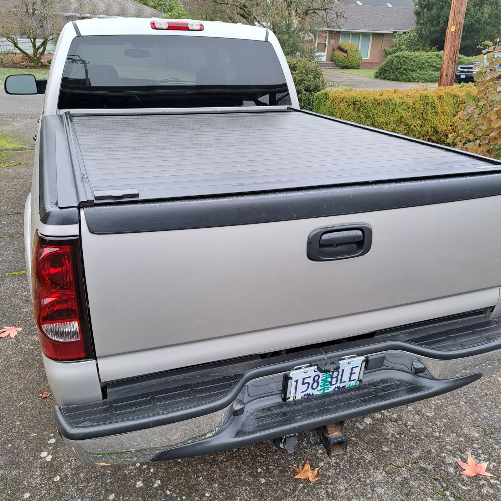

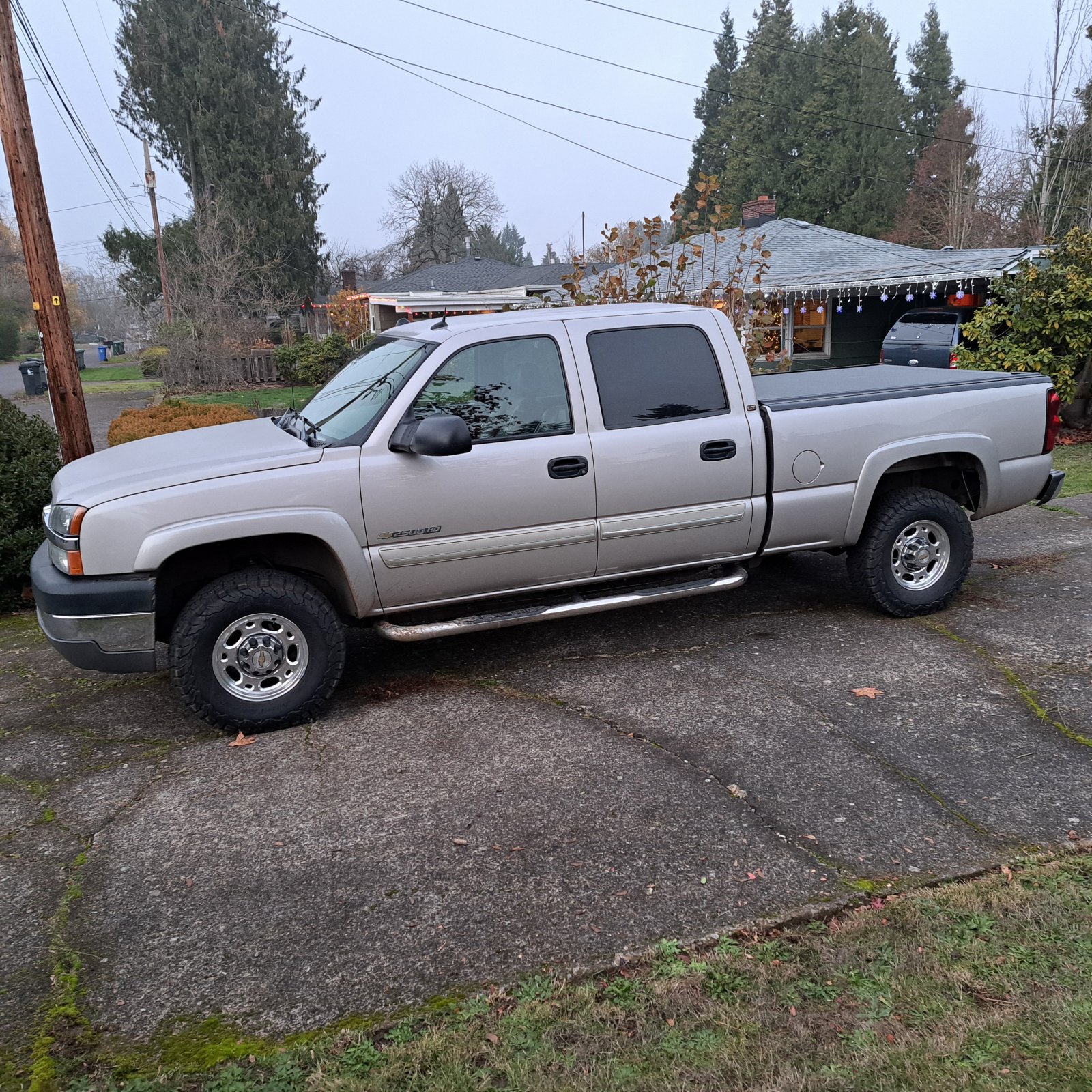

View attachment 456988View attachment 456989
I agreed with him and his choice. You ok?
For many safety is important. And these new vehicles have warranties so even if something happened it's covered.
Those old ones you enjoy so much break and broke during warranty too. And will continue to break with no dealer support.
I'm glad you found something you enjoy tho.
Beautiful!
I had a 2500 Chevy Express Van with 6.0l and I loved the way you could get 1500/2500/3500 versions as you could pick your brakes and suspension options.
Do you have the 6.0l?

Yes, the 6.0 is what I wanted and not the 8.1. I already have all the torque I need from the 6.0 with the 4.10 gears.
