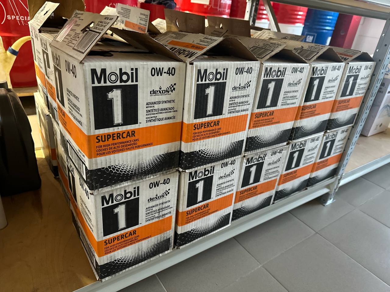

As far as parts availability when a Recall is released, it is almost always the case that parts are not initially available. If I owned a vehicle in the recall window, I would change to 0W40 now and document it, this way if it takes 3-6 months for parts and oil to show up, hopefully you would be saving your engine based on GM's solution.
Understand that there will be a Mobil 1 0W40 Supercar oil shortage!!!
They only made about 40-50k Corvettes the past few years, now you will need close to 6,000,000 quarts of oil at once!!! Good luck, I have what I need for the the next 15,000 miles and it is not Mobil 1.
There is no shortage of 0-40 oil. Even our services have enough of it)))
Why are you creating panic
