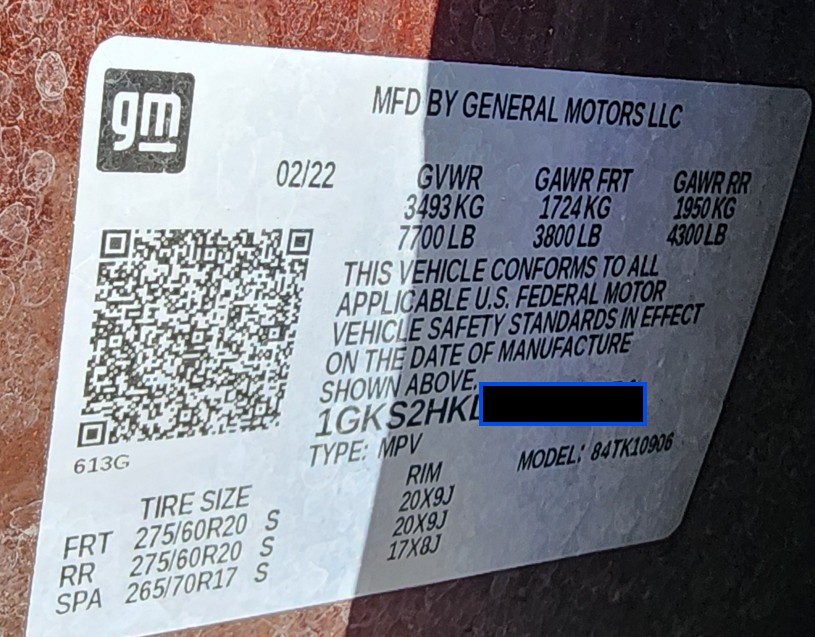

Yes, I get that. Just confirming that you're on the list. Thanks.
Yes, I'm on the list because I have a 2022 Yukon. But I'm still not going to switch to 0-40 oil. I'll stay with 0-20. By the way, our mechanics have learned to open the engine from below, without dismantling it, and change the connecting rod bearings. This operation is inexpensive, and in Russia, those who are at risk have already changed the bearings from the T1 generation to the red bearings from the K2 generation. They fit perfectly together.
Just throwing this out there, did you buy it in Russia or buy it in the USA and have it shipped there? I would think if you bought it there new at a GMC dealership they would take care of it. I don't know.

Просто выкладываю это там, вы купили его в России или купили в США и отправили туда? Я думаю, если бы вы купили его там новым в дилерском центре GMC, они бы позаботились об этом. Я не знаю.
I bought it in the US and shipped it to Russia. We don't have GM support or dealerships in Russia.
