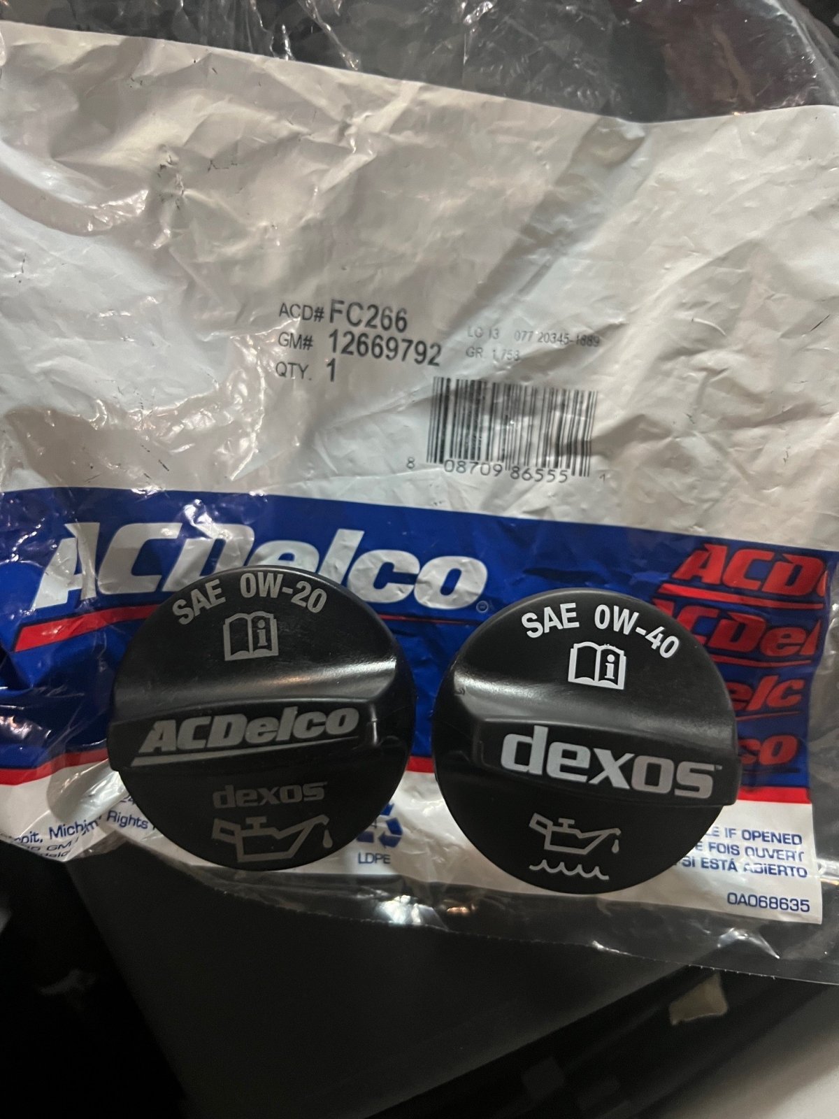

I called my dealer this AM and they confirmed that my engine was on the bad list.. I said what now? The service guy responded that he did not know and that they did not have clear direction from GM. He said that they had been originally been directed to change the oil wait but now that plan was being scrapped.. Oh boy
I have talked to my GMC Dealer twice. They will not be ready until June. I asked about coming in for an oil change but wanted a heavier oil than the 0W20. They say no, that at least until GM approves of something else they need to stick with what is written. I am also thinking about going to an oil change place with my own 0W4 oil and just paying them to put it in.

I agree. Doubling the weight of the oil in an engine that was specifically designed to operate with the lighter oil seems like a dart toss.
Agreed, but my only comment is that heavier oil is better than doing nothing, at least I hope that is the case.
