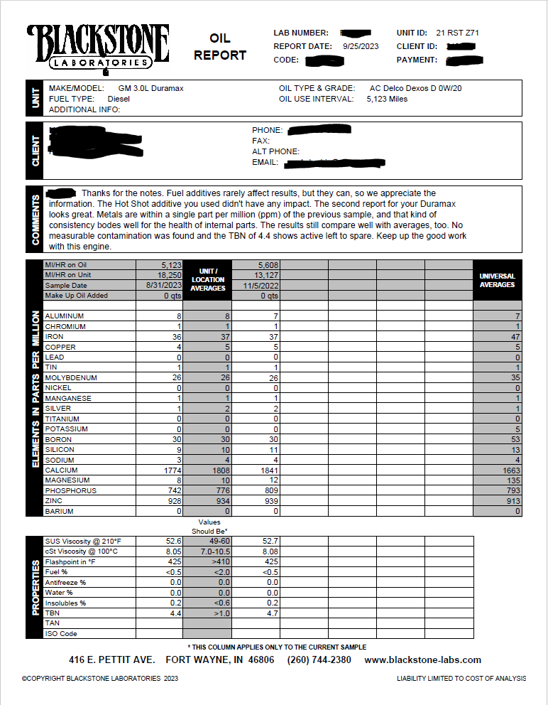

No one is saying “babying” their car. I said “take care of your car, it isn’t a race car” hell theres a dude on YT how has a 23 diesel xl that has over 150k already. If im not mistaken he’s in the transportation business. That dude takes care of his car.
Sauce:
